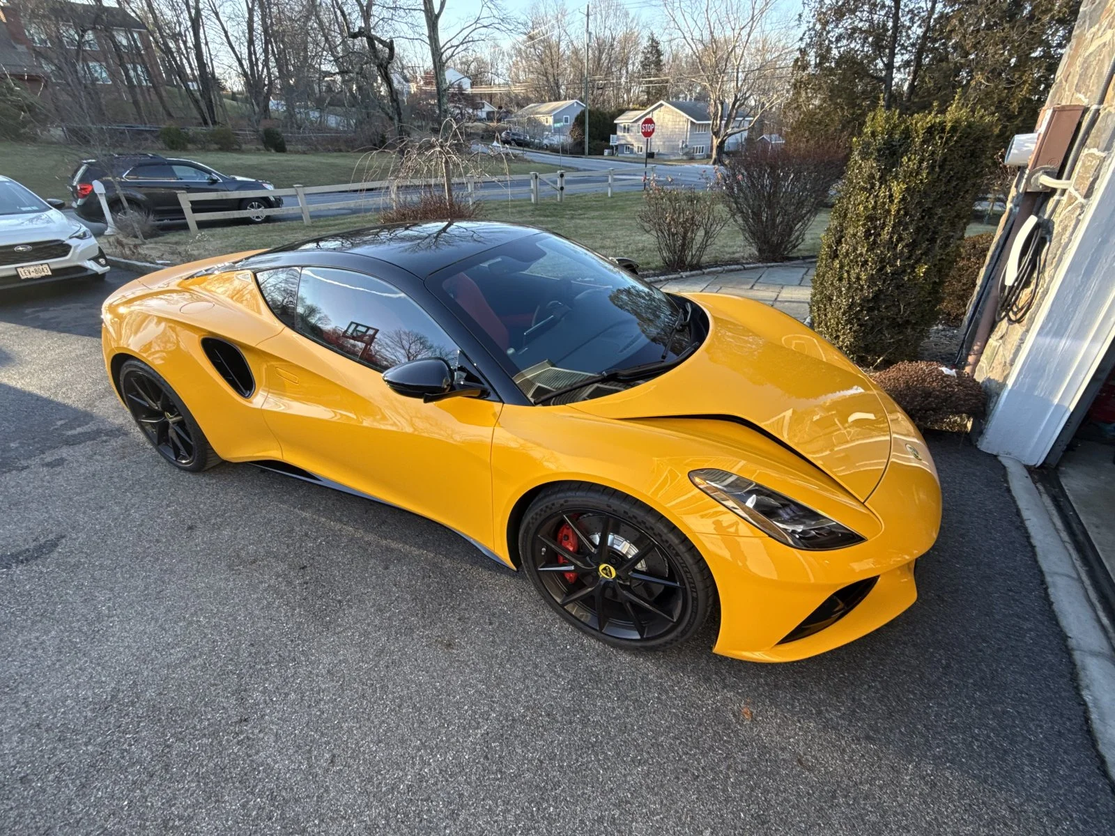

Took her for a nice drive on a beautiful day post snow post raín ( yes to clean up salt debris) . Car is awesome 😊

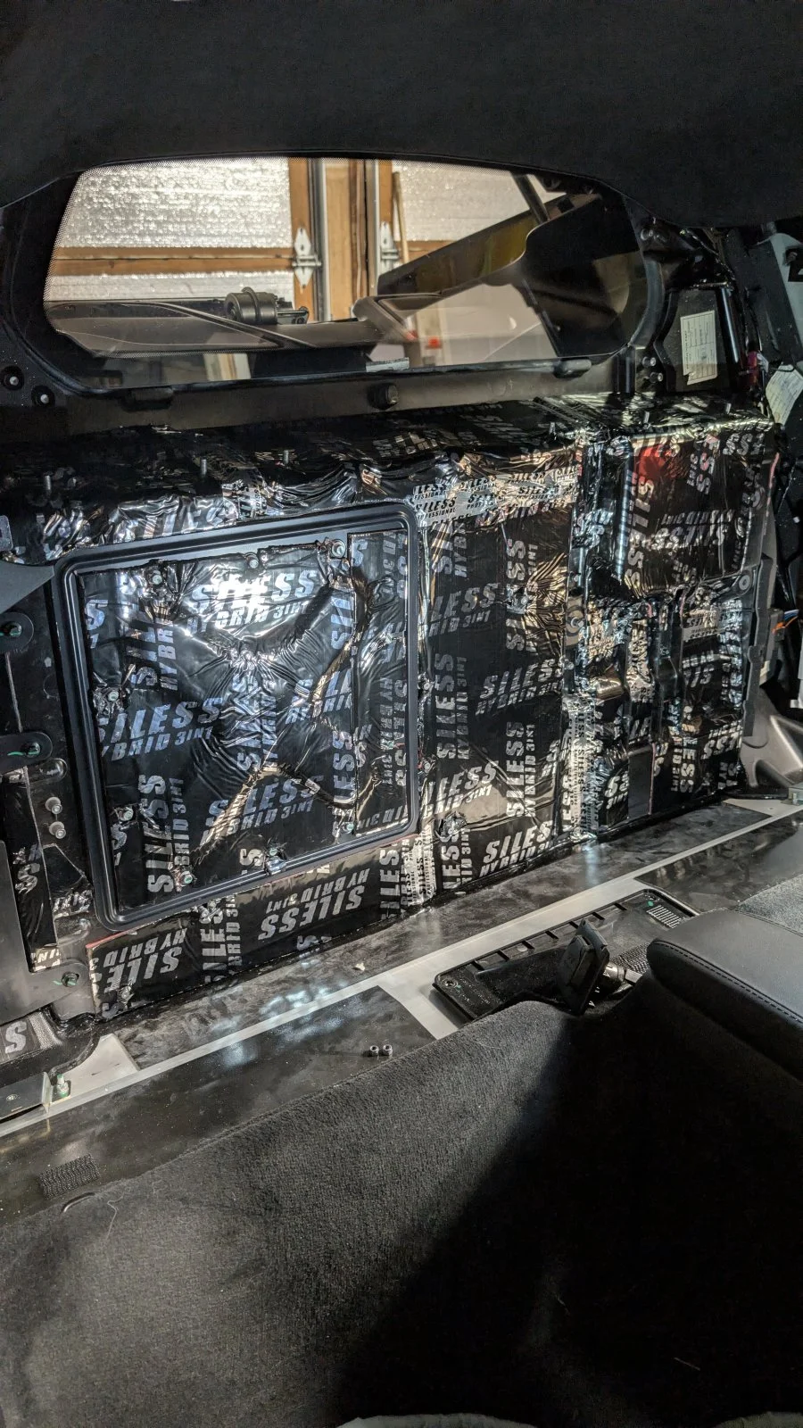

I took less time than I had imagined. Started hmm..1-2pm Saturday, busy Sunday, Monday after work was basically done when wife wanted to do a Costco run.
In total, If I was prepared with everything I needed it's maybe 4-5 hours to get in there cut stuff to size and put it back together. It's pretty tight space to work in though. I didn't take a seat fully out but it would be smartest to do that to both seats.
I get pretty easily distracted though, started really looking at how these cars are put together, looked at the speaker mounts, etc. Plus dropping screws down into unreachable pockets adds time.
I've only done the back firewall and a little into easy spots on the qtr panels. I'm thinking I should do *something* in the doors. Probably just a strip or two to knock down some high frequency, not skin the whole door.
I'll put the seat back and fire up the engine to get an initial impression though.
Goal is to add less than 10lbs of material.

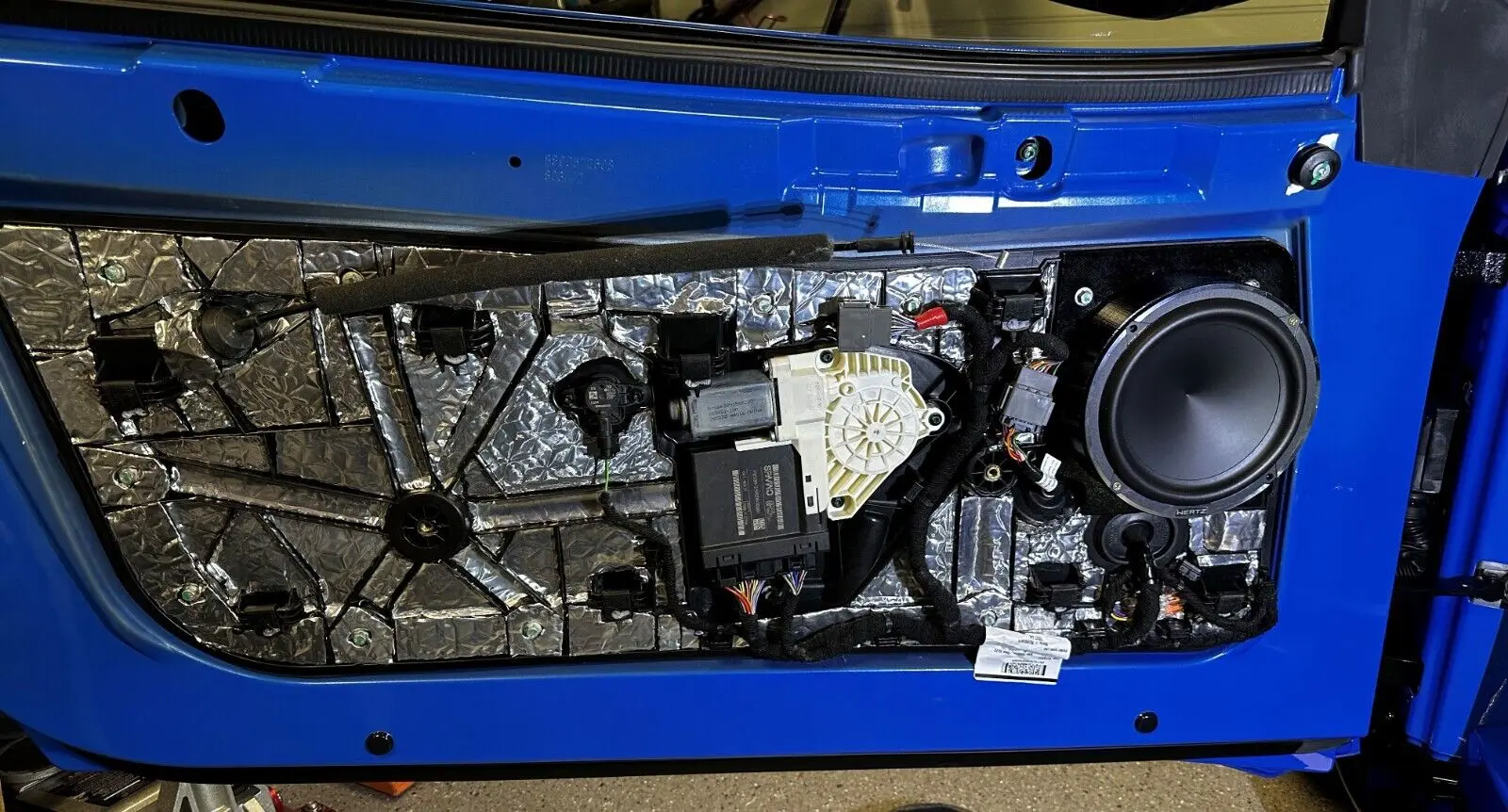

Not sure if you've seen this picture of the guys who did a sound system upgrade in the UK. They also did a meticulous soundproofing job on the doors resembling a jigsaw puzzle. The picture could help in planing for your project, if you choose to go ahead with it. Looks painful, but I may take a shot at it myself sometime in the near future.

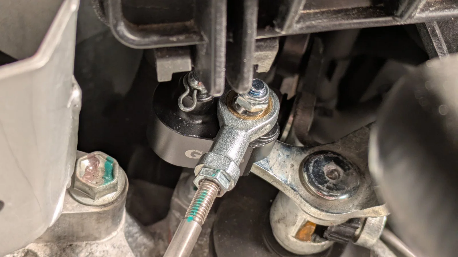

I didn't drop the cotter pin, but dropped the OEM eyelet :rolleyes:. Will need to retrieve at the next oil change.
Shift feels nice and short, but not as stiff as expected (which was a pleasant surprise).

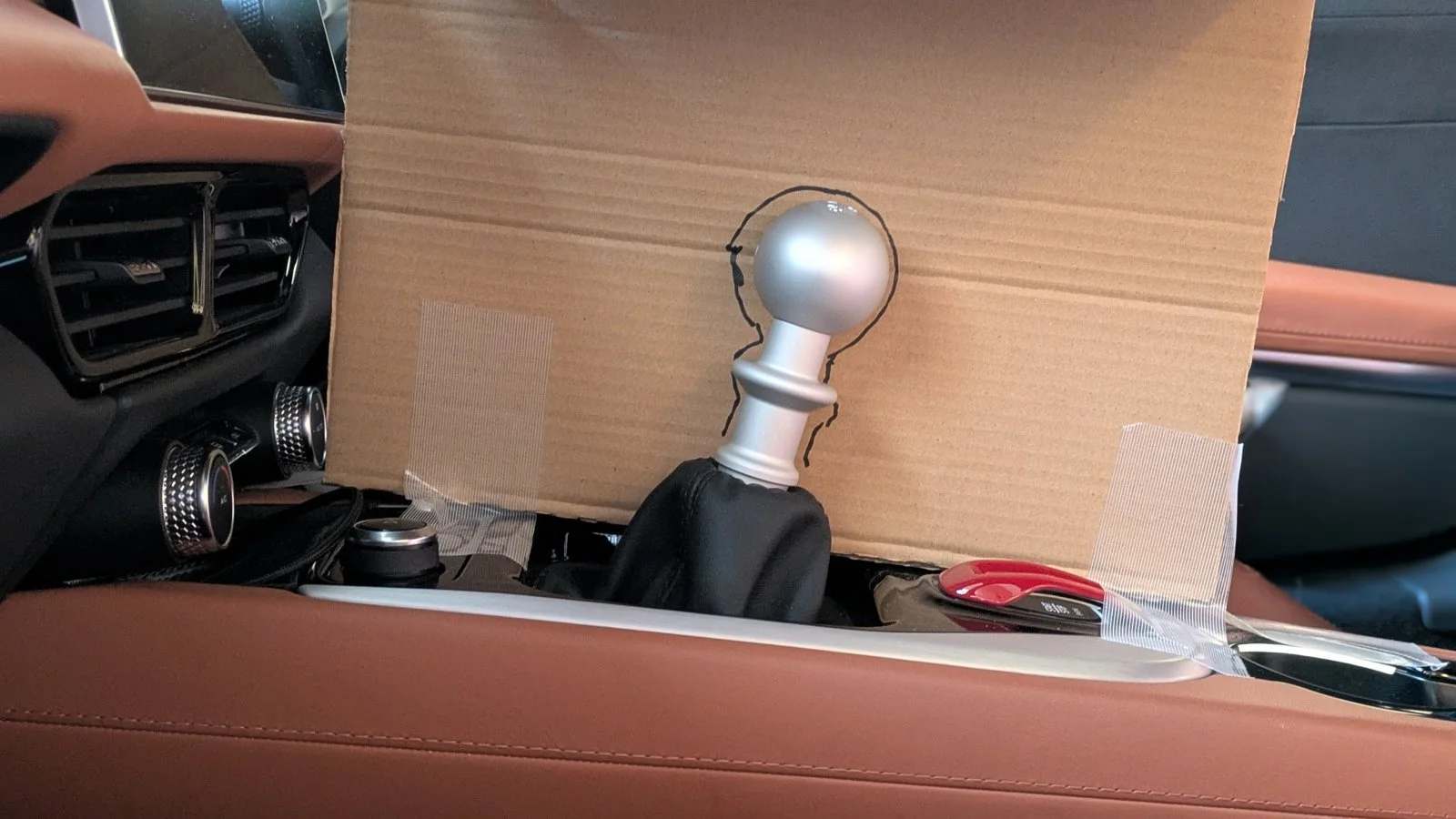

Bespoke template for shifter position adjustment.
I've seen a few of those photos floating around.
Gotta be honest. I'm not sure that's the best way to accomplish what needs to be done.
I would think actually that the best application would be on the outermost door skin, effectively between the door and the pocket the glass will drop into. It's also going to be the smoothest part to apply material to because it can't have any brackets or protrusions as they'd interfere with the glass.

On the drive after button everything back up. Result. It doesn't pass the "would my wife notice" test.
It might lower the sound floor, and on a real long drive may result in a less fatiguing experience. However, it's not noticable by anything more than a placebo effect.
I will have to drive back-to-back with another car to be sure, but the bulk of the noise is just background super charger whine, and that's not going anywhere. I suspect mostly coming through the glass.
