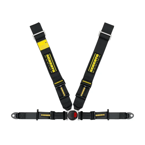

My Elise has a four point harness (badly) fitted; I have never used it. Schroth Racing do make a four point anti-submarining harness that addresses the safety concerns by allowing one shoulder to rotate forwards in an impact - exactly the characteristic that makes a standard three point belt so safe and effective. I'm thinking of maybe getting these fitted.
