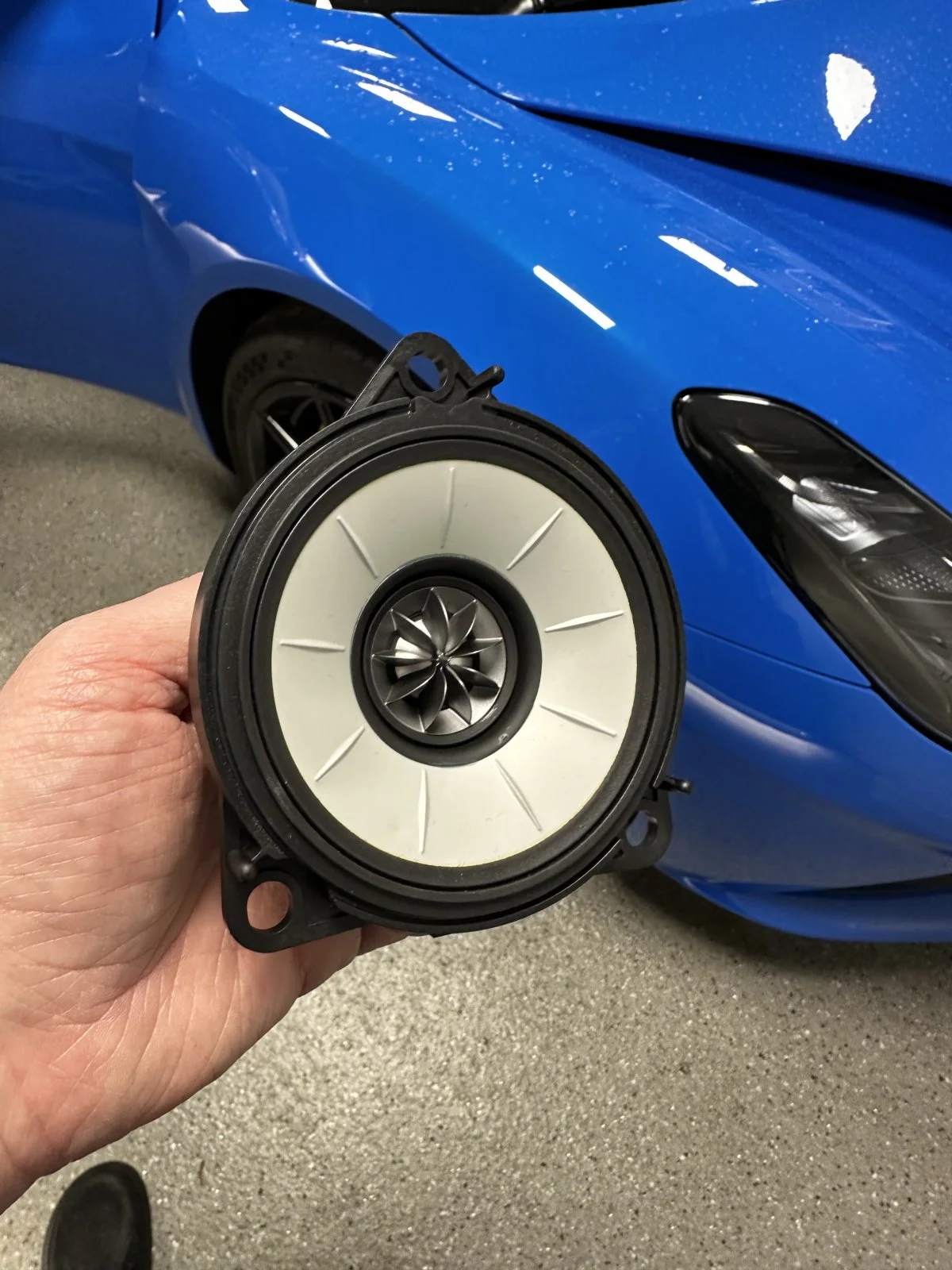

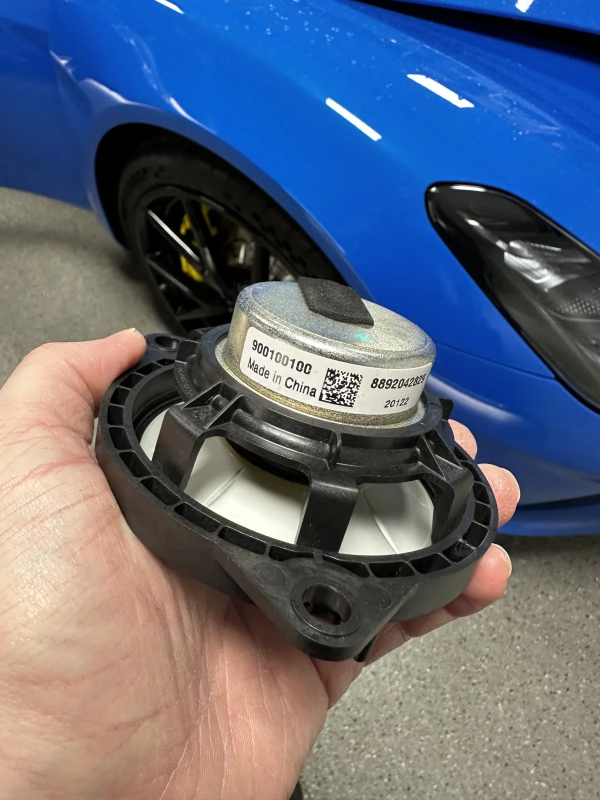

So is the center a dual voice coil speaker?
I'm not interested in a center speaker for my music, will probably change to 6.5 in doors and tweeters in A pillars. Might hook up the center speaker to radar detector audio.
To answer your question - The center speaker is the same as what are installed to the doors.

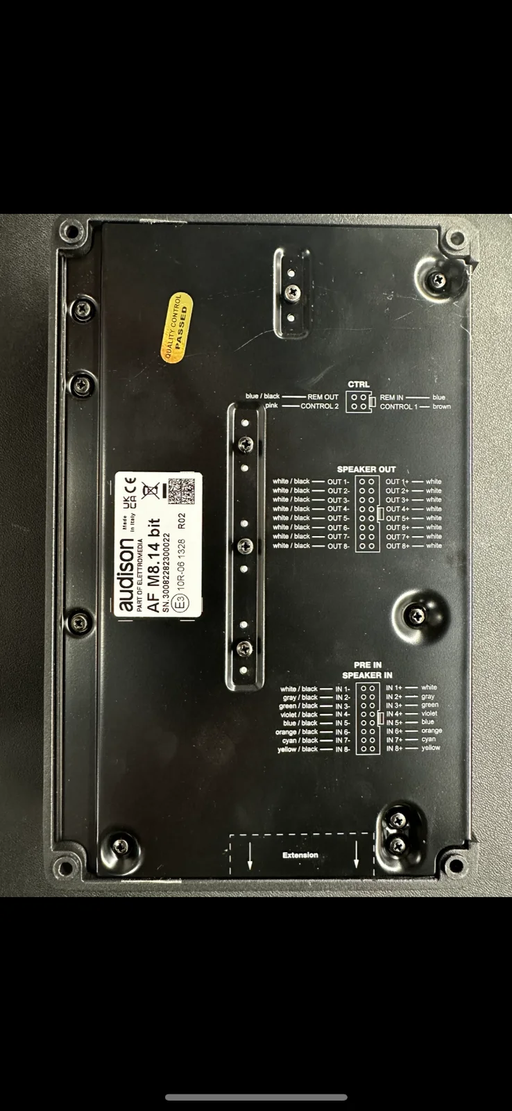

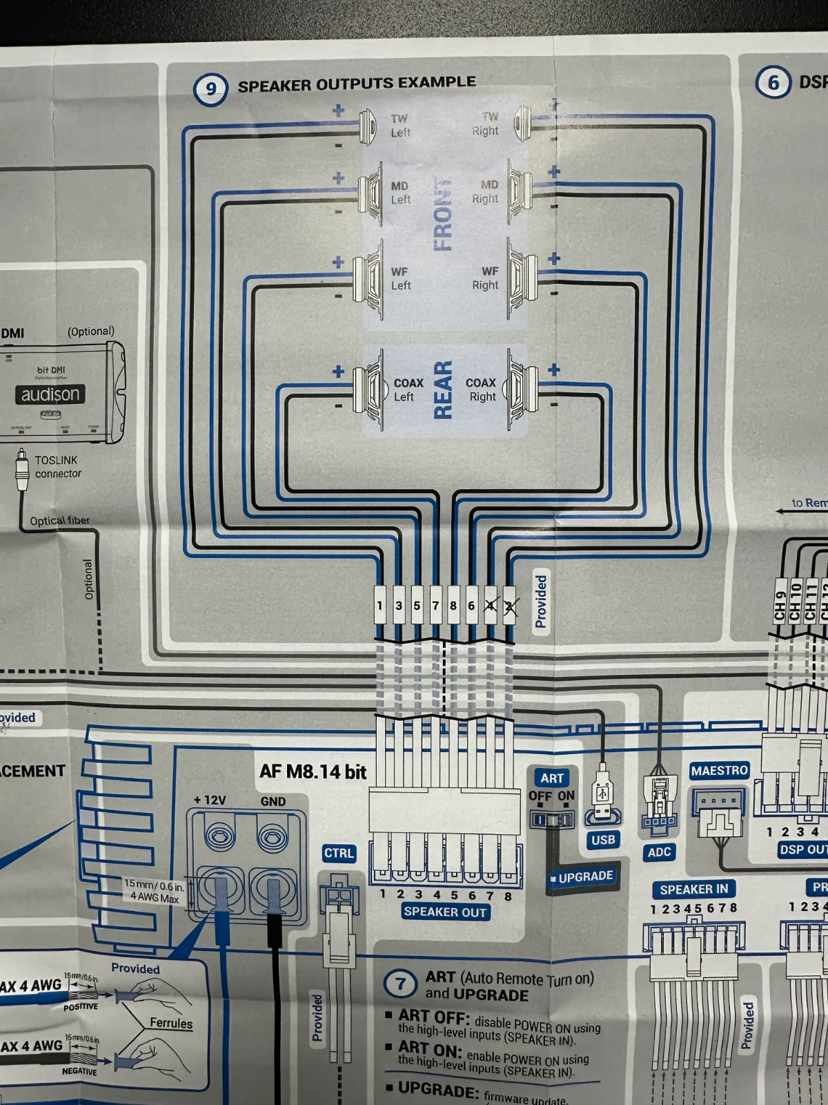

It's worth mentioning that with the kit we provide a wiring color code document. This has all the details you'll need to complete the install, (all speaker wire colors, and from which of the two OEM Amps they are fed from), therefore saving hours of identifying and tracing wires to each speaker.
Audison also supply their easy to follow documentation, and the amp comes with all the plugs & connections. All that is required is to join the wire colors our document highlights to their input channels. I've attached a couple of pictures - You'll see the wiring colors from Audison are printed on the bottom of the amp. The other picture is their wiring schematic.
