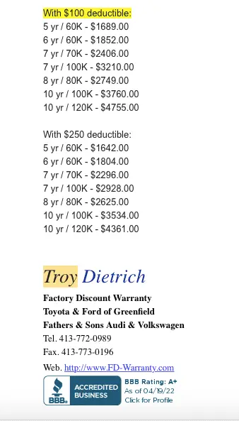

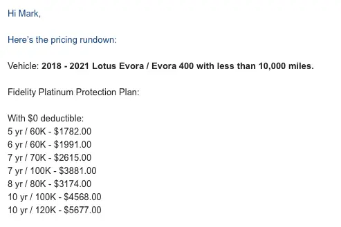

This is so true. Exactly why I stopped looking at exotics and even new Porsche alternatives. Upkeep costs of Lotus, especially with the Toyota engine variant is almost Camry like and approx half the cost of an equivalent Porsche upkeep (during the warranty period). Post warranty most major engine parts are available at the local Toyota dealer. How damn awesome is that!
Always figured those warranty plans were a scam - you ever actually use one?
I have purchased one for every car I have ever owned. The key is to buy them for dealer cost + $50 over,..... which this seller does.
The warranty carrier/company lost money on the coverage they sold me 6 times on 6 different cars they paid out claims on, ( twice big time costing them over $4500 for single repair.... twice) and once the contract broke even because the claim they paid was equal to what my cost for the premium was, and once they made $1500 profit off me since I had no clams.
Overall for the past 20 years I am ahead about $25,000 in claims they paid out vs what I paid in premiums to purchase all the coverage on my cars.
Garage queens don't need coverage, daily drivers do.
