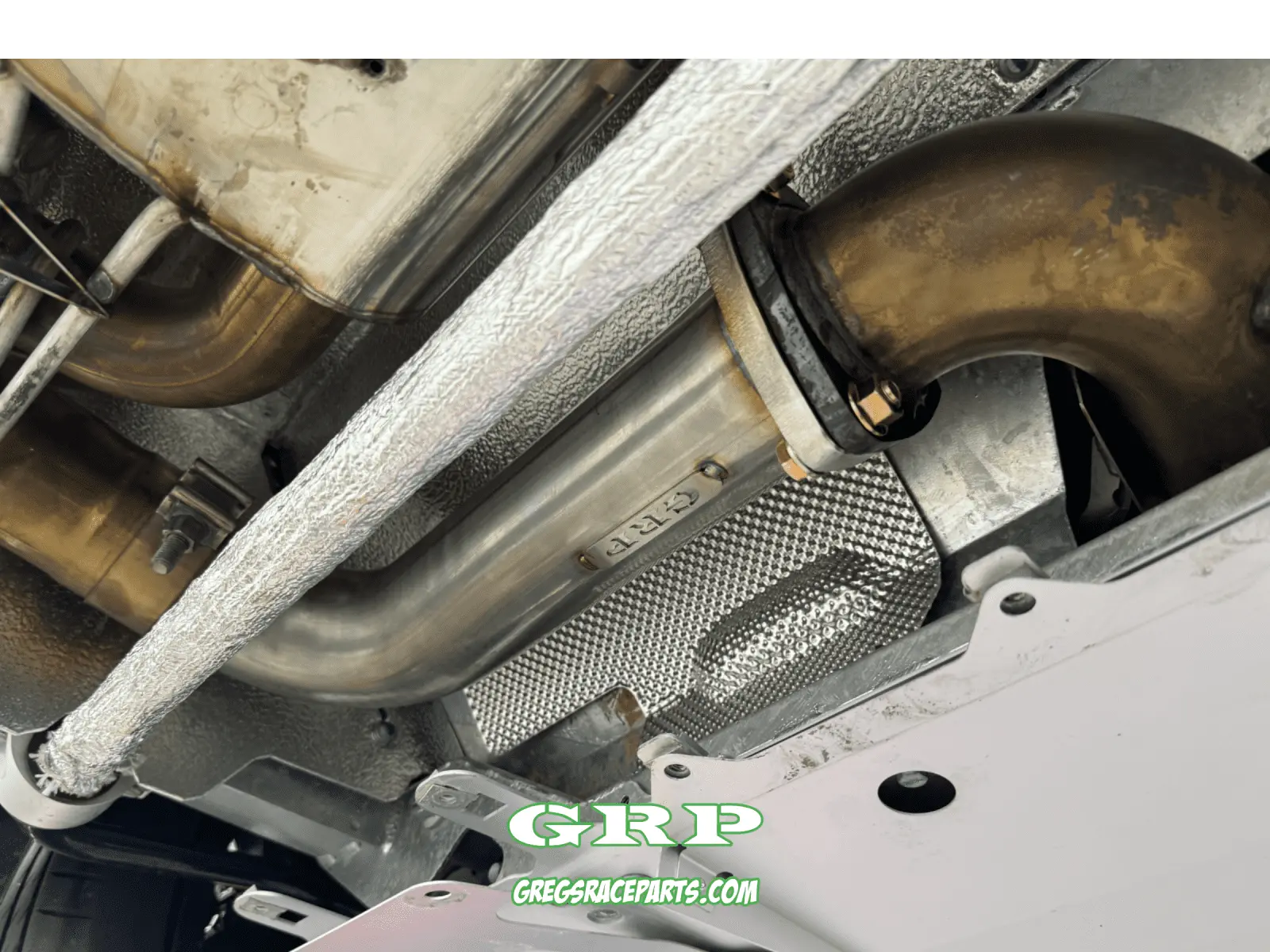

Installed the GRP decat and Milltek valve controller. It really brings the car alive. The sound difference is VERY noticeable in a positive way. Much more aggressive and deeper tone and louder in general.
It could be a mental thing, but the throttle response feels a bit sharper and the car definitely seems slightly quicker. I'm sure it's not a huge gain in power but the sound in and of itself is worth every penny.
Also, it takes 30 seconds to program/map the mirror Homelink buttons to the Milltek controller buttons so I just stowed the fobs away in my glovebox with the manuals after doing so. Now i just press the middle button for loud/fully open and the 3rd button for quiet (which is basically only for long highway hauls or entering neighborhoods at sensitive times).
What a fantastic pair of upgrades for relatively low cost. If you're not in a state that does CARB testing, I HIGHLY recommend you delete that third cat ASAP! Thanks @GRP. The pipe fit great. It was a bit snug and we had to use some channel locks to clamp it onto the midpipe but overall it was a smooth process (we were using a lift so that helped a ton!).

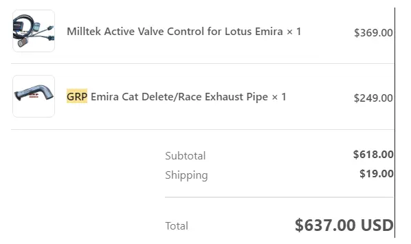

How much did it cost?
My brother owns the shop so the installation was free. A competent shop should be able to do the install of both in less than 2 hours total from start to finish so I don't think it should cost more than ~$300 if you don't want to do it yourself. Of course that all depends on cost of labor in your area.
Parts from GRP:

Just finished a write up/how-to for the the decat install.
Im no writer or journalist so its basic but serves the purpose.
Give it a look below!
Few take aways --
  • Install took about 45 minutes on our shop car. Now I have done a lot of these on prior Evora's so know a few tricks but overall it wasnt very difficult and learned a few new tricks along the way.
  • The muffler and other items 100% DO NOT need to be removed. See the pictures in the install doc.
  • You may need a new gasket, ours was fine but we have had a couple others who had crumbly ones when swapping. We are working on getting stock of some oem replacements as well as investigating some off the shelf options from Napa/Oreilly's etc.
  • The decat pipe alone sounds great and is a really nice improvement but when coupled with the Milltek valve controller its like a whole different car! The exhaust valve doesnt open 100% at idle and low rpms but instead gradually opens/fluctuates depending on load/rpms. The Milltek controller keeps it 100% open or closed with the press of a button and also remembers the mode you had it in when you shut the car off. So next time you cold start it and you had the valve open prior it sounds pretty killer! You no longer are funbling to get it into sport mode to get some sound out of it.
GRP EMIRA DECAT INSTALL DOC
