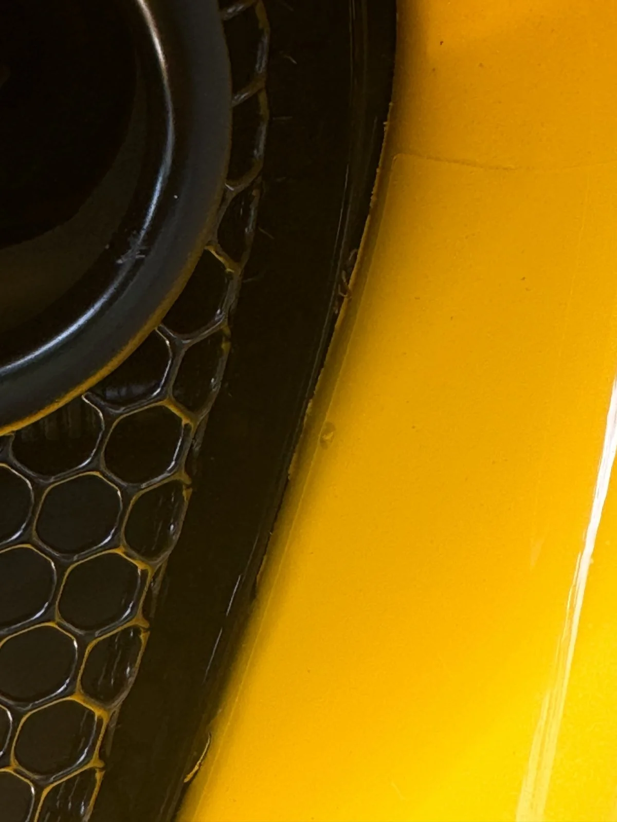

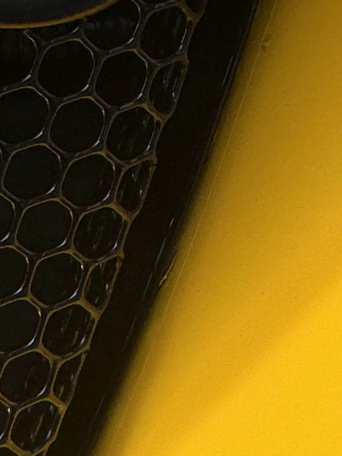

My car has paint blistering in the "O" of LOTUS in the back.
Is it true that this panel can be repainted at a local shop?
I am tempted to just pay some cash and have it fixed isntead of see my car be taken away for long time at lotus.
paint quality on these cars are really shity . Wondering how rough are your edges guys

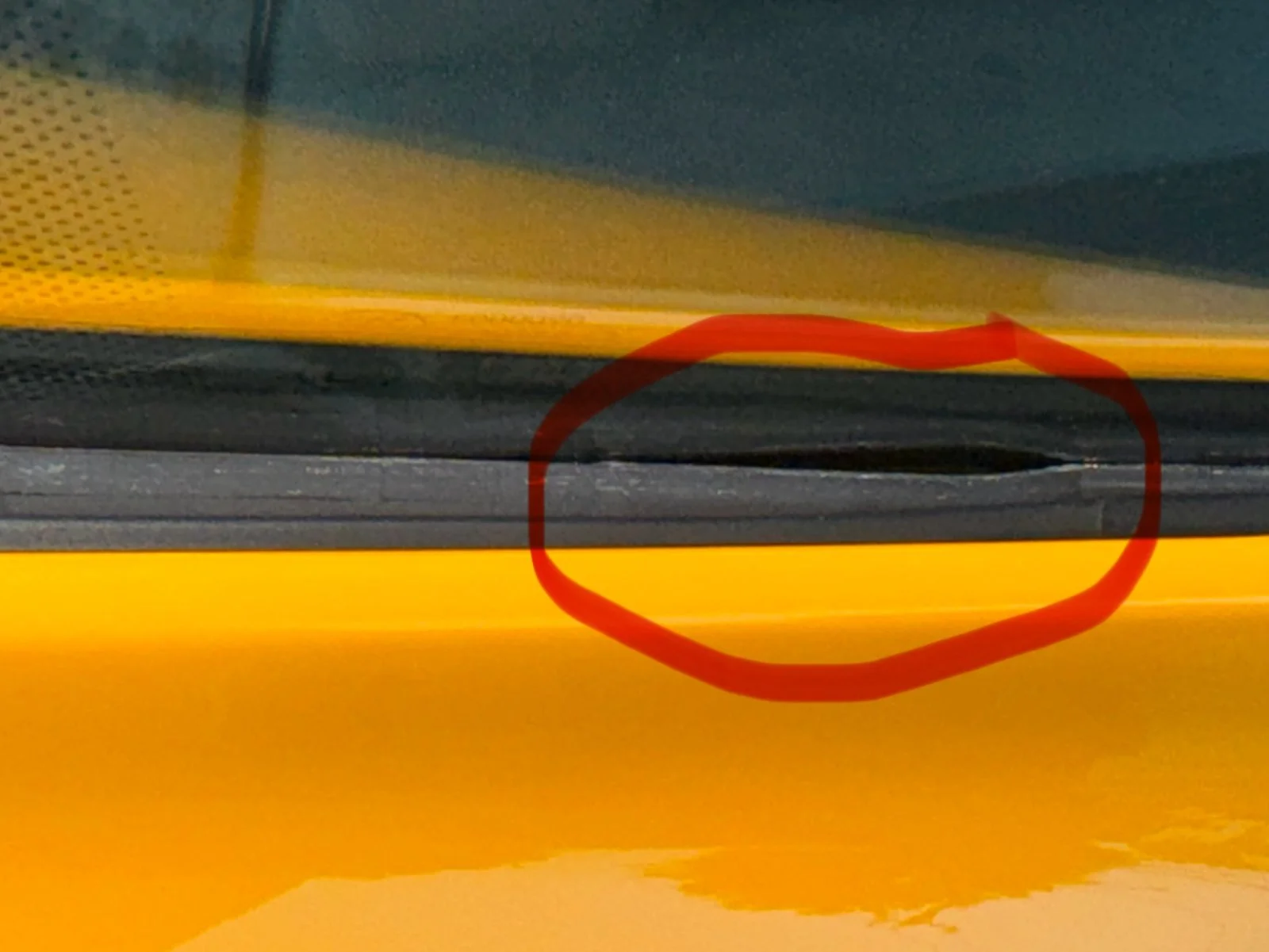

Window seals both sides there is a gap maybe that’s why water getting there ?

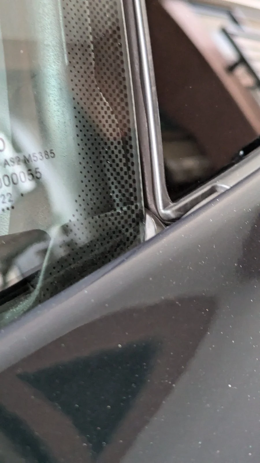

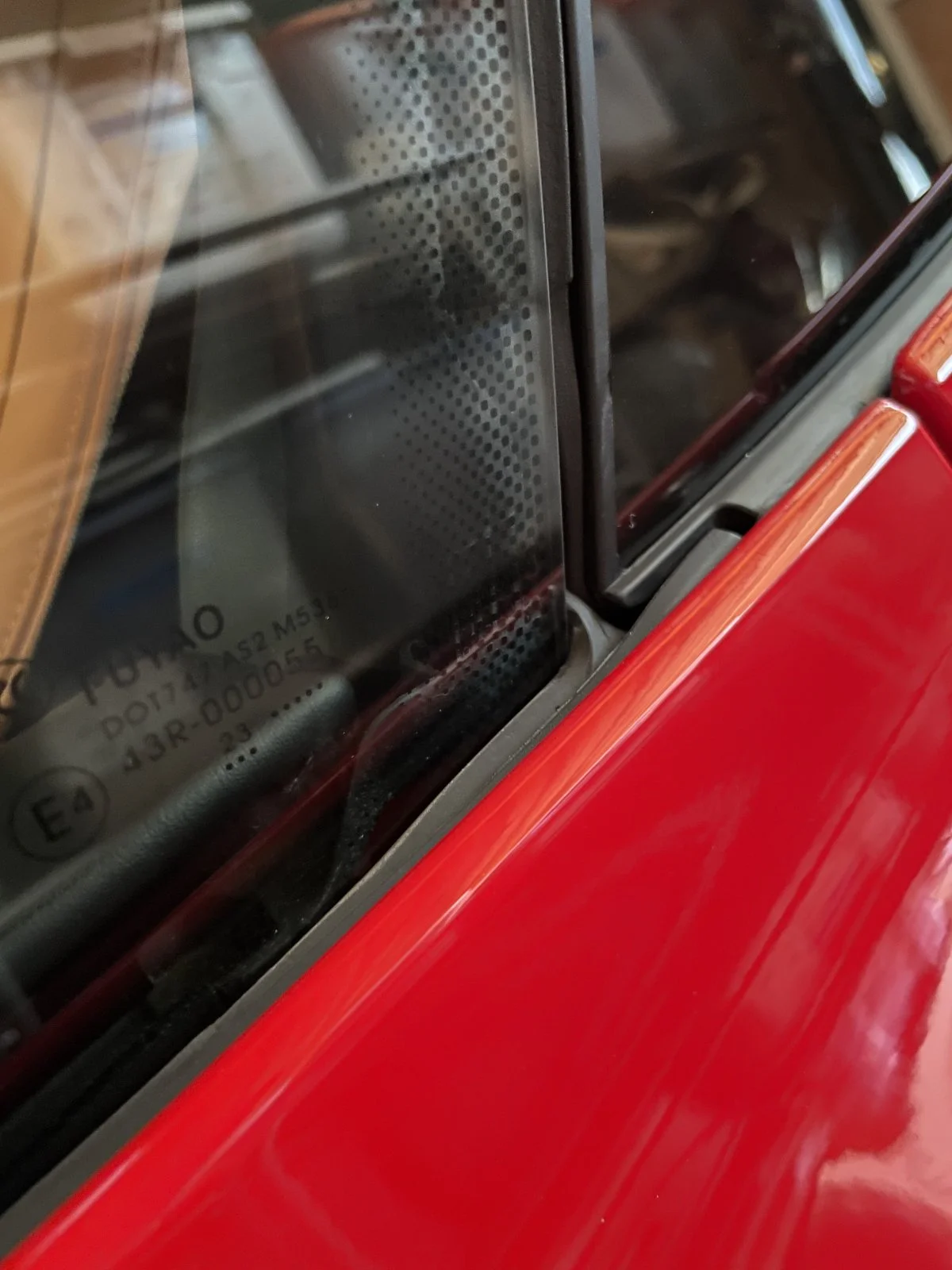

I also noticed while washing my car that there is a rubber lip at the rear edge of the window seal before the door meets the rear quarter panel. This lip catches water and kind of drains it into the door itself from what I recall.
Would you mind taking a photo ? Is that normal ?:D
Seems like the same weatherstripping used for the seat cushion fix could be used to push the seal flat against the window and close the gap. Not sure if that would remedy the blistering issue but the gap definetly should not be there.
Hopefully new seals won't have the same gap.
I would think some gap to allow moisture to escpe isn't a bad thing. No way you prevent 100% of water from getting in there.
