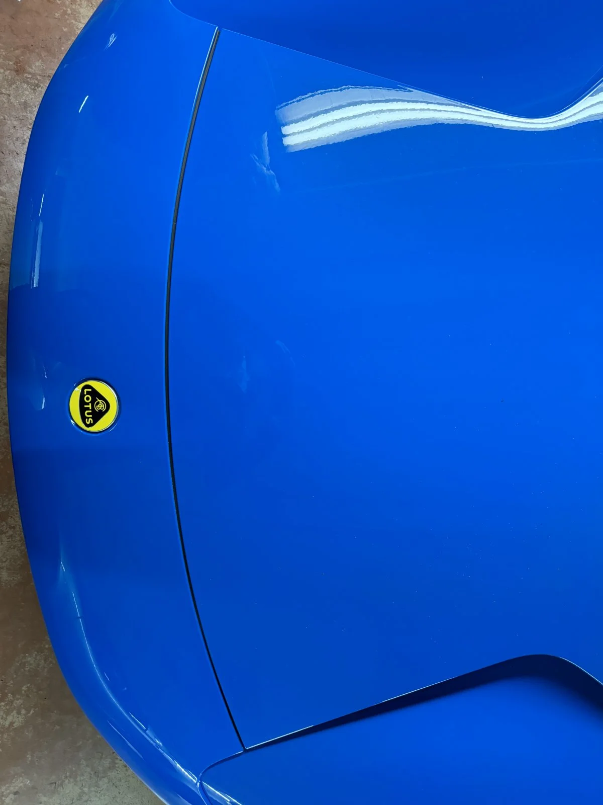

Excuse the dirt - My correction/PPF/ceramic guy asked to have the car delivered dirty next week.

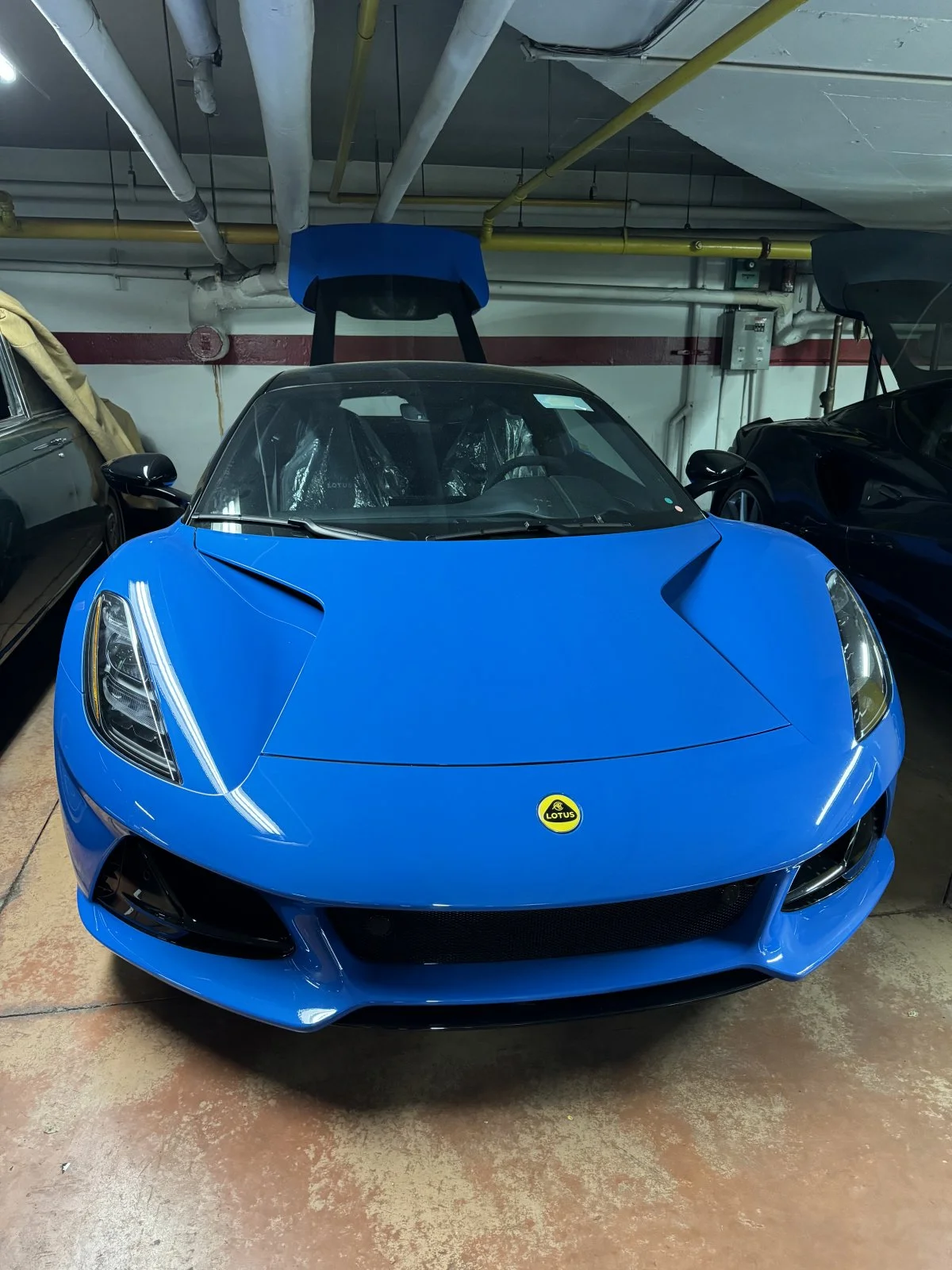

My super common spec with a slight wrinkle by getting the privacy glass delete like the show car, believe it or not the first I’ve seen my spec as everyone ordering it seems to have gone for the privacy glass. Last pic from the dealer when the truck dropped them off on Saturday (back right).
Everything looked good on my walk around other than the hood is misaligned as seen - assume fairly simple correction the dealership can do (makes you wonder what kind of PDI they do in Hethel lol). Likely finish the paperwork tomorrow and have it transported for PPF at the start of next week.

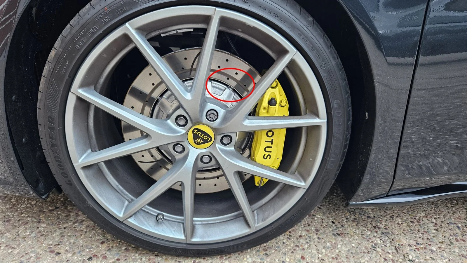

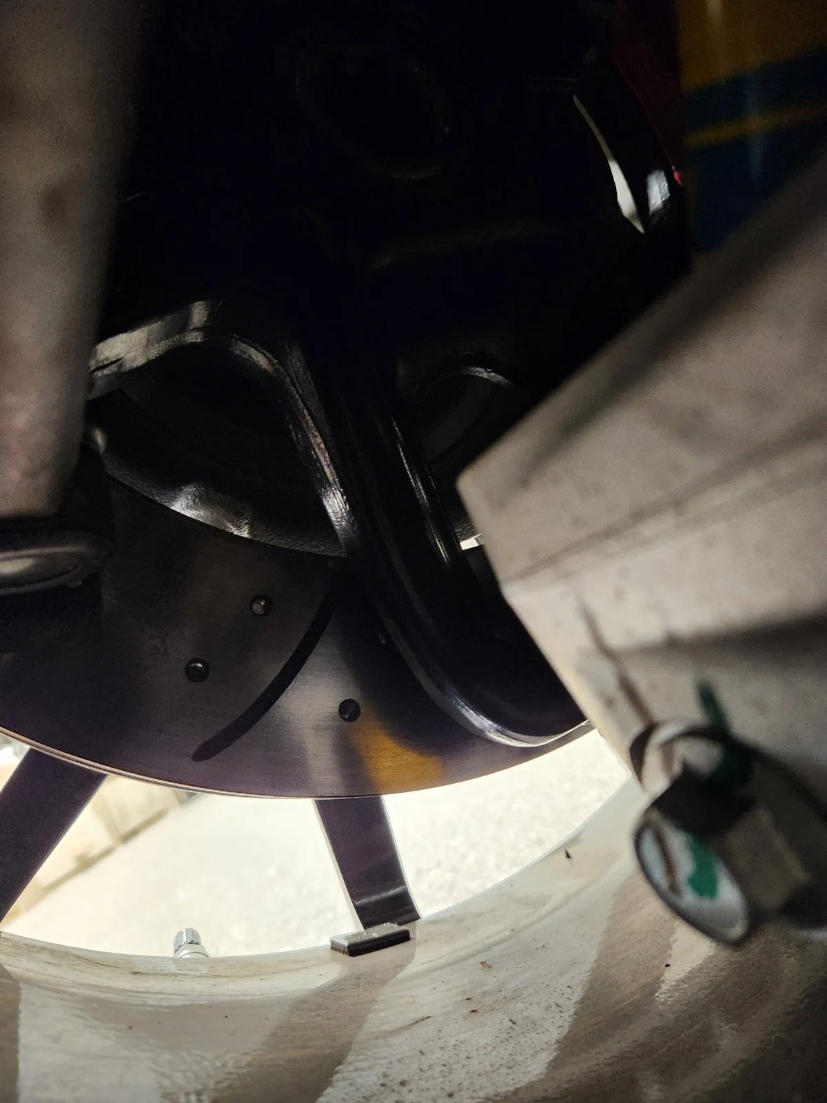

Hi, I know some Emira owners have issue with brake disc (missing chunk of brake pad) associated with cars sitting long before delivery. (Car arrived at Baltimore 3/29, took delivery 5/25).
Can you guys take a look at my photo and confirm if this is what it looks like. This is on my left-front brake disc but not on any other 3 brake discs.
TIA.View attachment 45064
Yes, this looks like the result of a fractured brake pad.

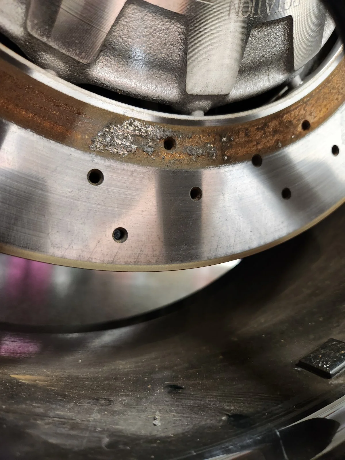

Well, I just joined the defective brake pad club!
Right side front rotor. Inside surface is fine. Car only has 400 miles on it. Closest service center (Chicago) is 400 miles away. They need to see the car in person to decide how to handle this (which I get).
Brakes are a consumable. Where do I find OEM front brake pads? The rotor is fine (I think the little chunk of brake pad would easily machine away at any brake shop). It just doesn't make sense for me to make an 800 mile round trip to address this. The rest of the brakes are fine. I'm KICKING myself that I didn't notice this when I took delivery.
Never occurred to me to check the inside-sides of the rotors. Thanks for the perspective
Sorry to say, you have the brake cancer too.
