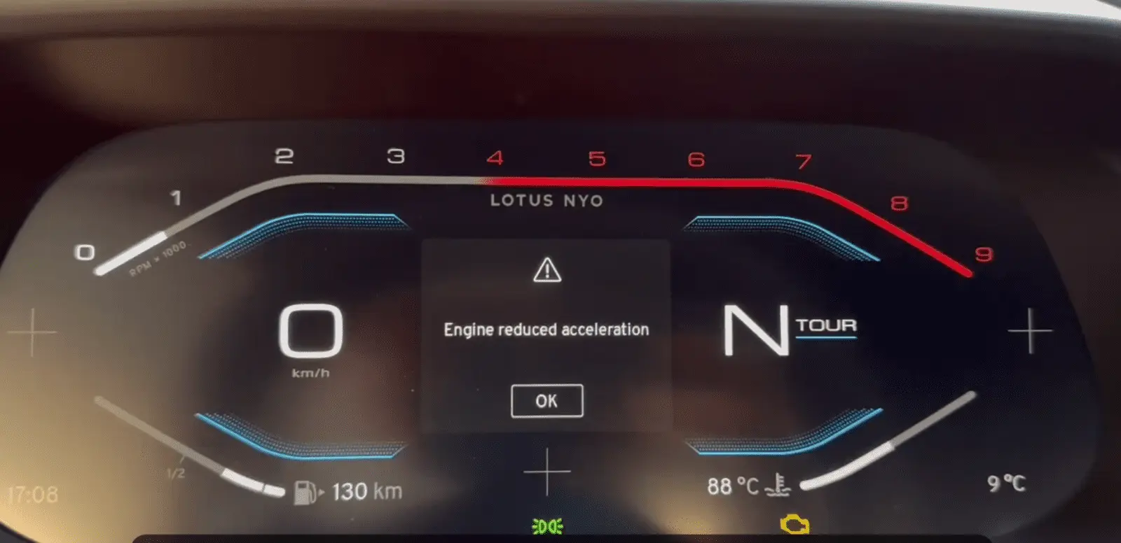

Car shows "limp mode" or "reduced acceleration" warnings (possible ECU issue)

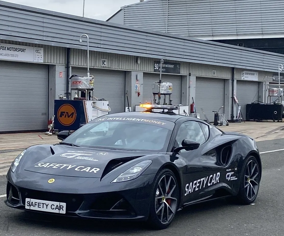

This was happening to the car I drove on track at Hethel when I did the Driving Academy back in August.
Which car? One of the cars went into limp when I was there too (September). The DV car I think. Those were pre-prod cars so I didn’t pay much mind to it at the time.
@GetawayDriving I drove the Shadow Grey "Safety Car" because it was the only LHD car they had there.
At one point they put me in a RHD car, they said they needed to "save the brakes" on the safety car because it was going to an event the week after (as if they didn't have a factory full of brake pads within walking distance lol). So needless to say I also killed a few cones. That's cool you got to keep one!
They brought the car back for the next session when someone complained about how far they came and how much they paid to not be able to drive a LHD car.

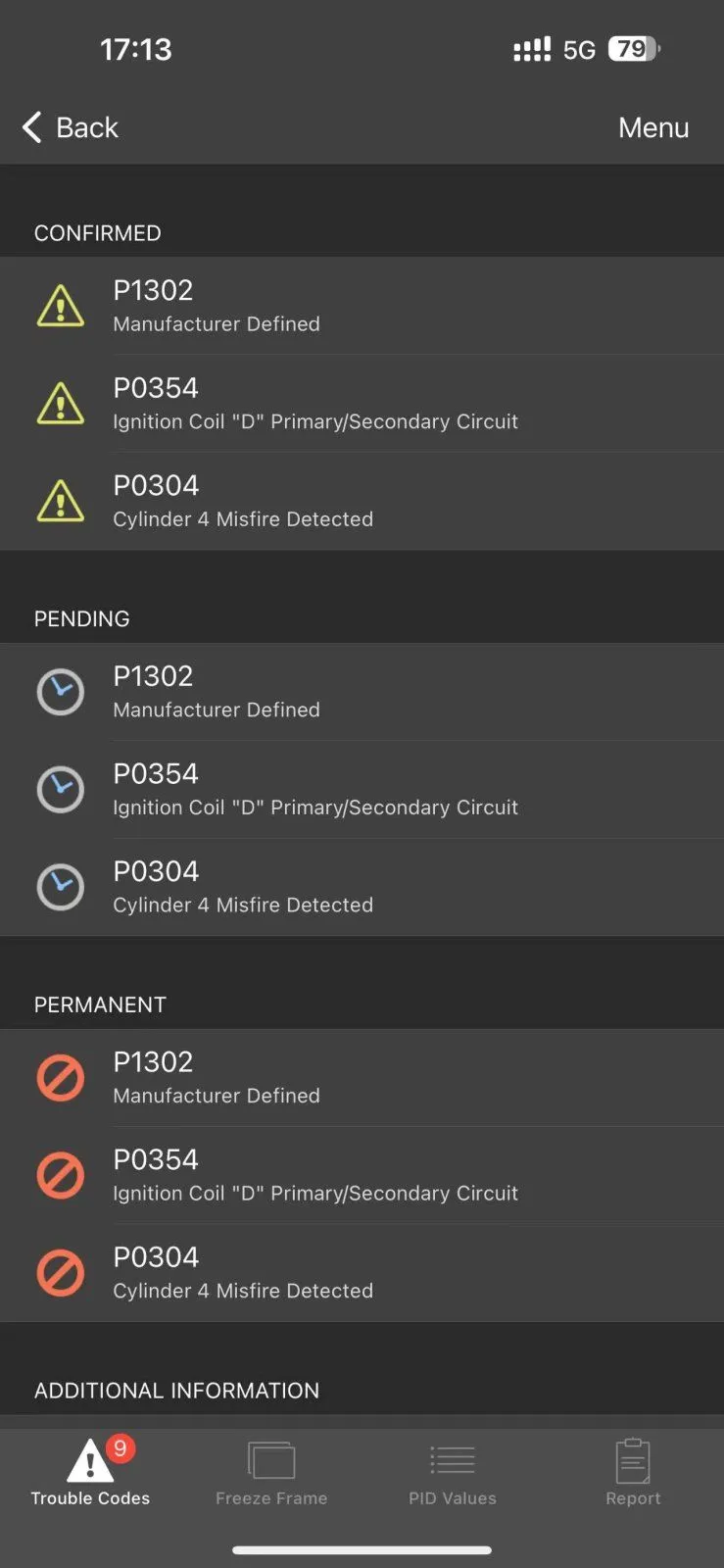

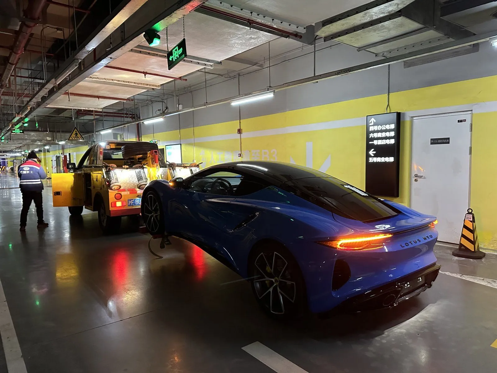

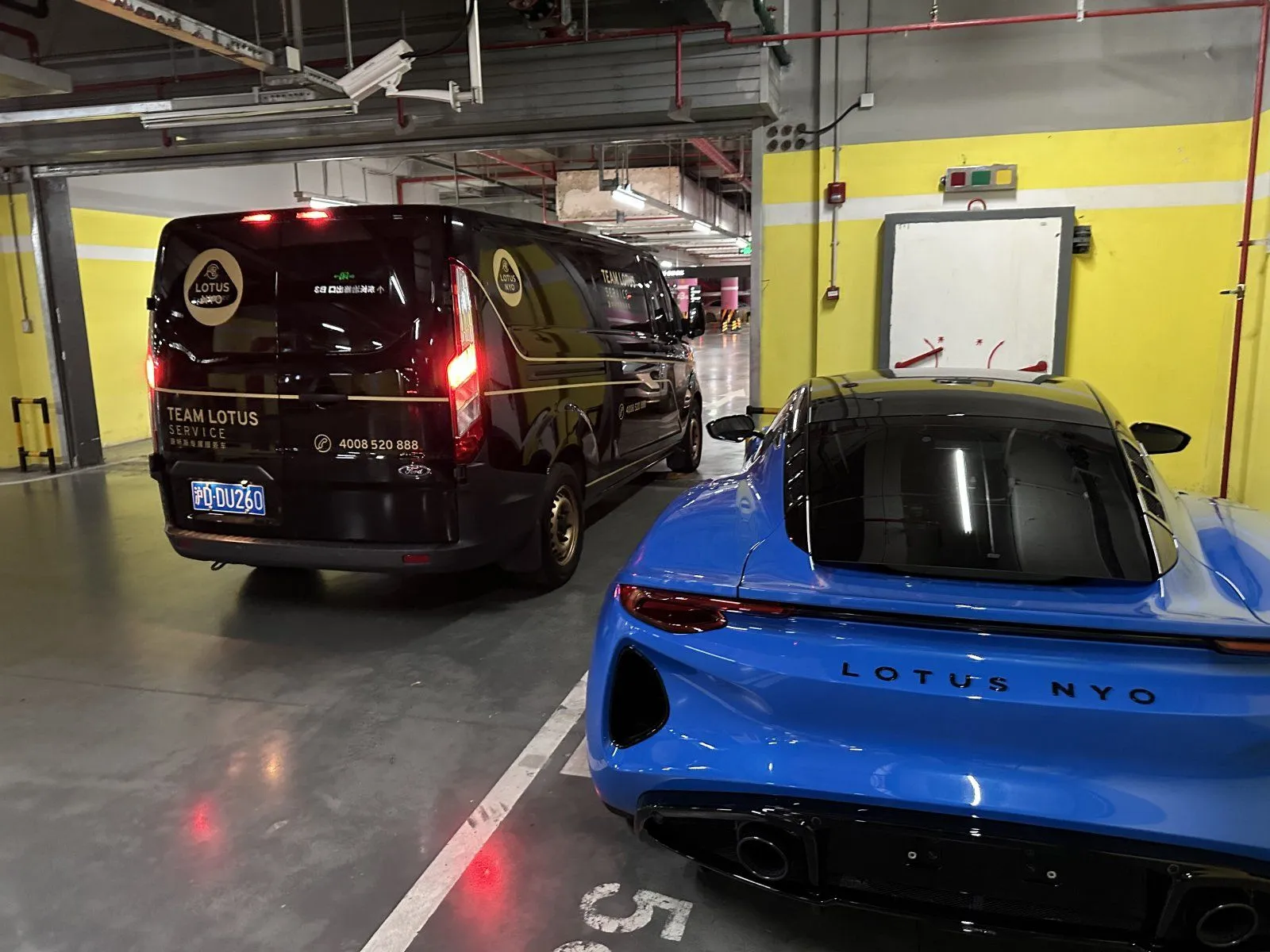

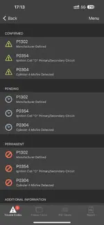

My Emira had the same issue after only 1900km of driving (1 month). Lotus Shanghai sent us a service vehicle to diagnose the problem and possibly found the faulty ECU. The vehicle was towed back to the Lotus flagship dealer to be further diagnosed. I would update this post once I hear more information from the service team. The vehicle could not start nor detected the keys a few days before the reduced engine power output warning message.

My Emira had the same issue after only 1500km of driving. Lotus Shanghai sent us a service vehicle to diagnose the problem and possibly found the faulty ECU. The vehicle was towed back to the Lotus flagship dealer to be further diagnosed. I would update this post once I hear more information from the service team. The vehicle could not start nor detected the keys a few days before the reduced engine power output warning message.

The car I drove at the performance academy back in Aug 22 had the same limp mode issue.
