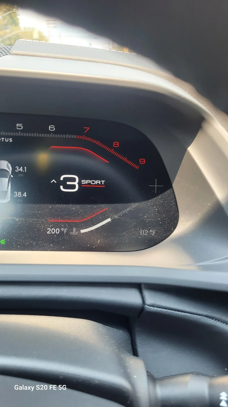

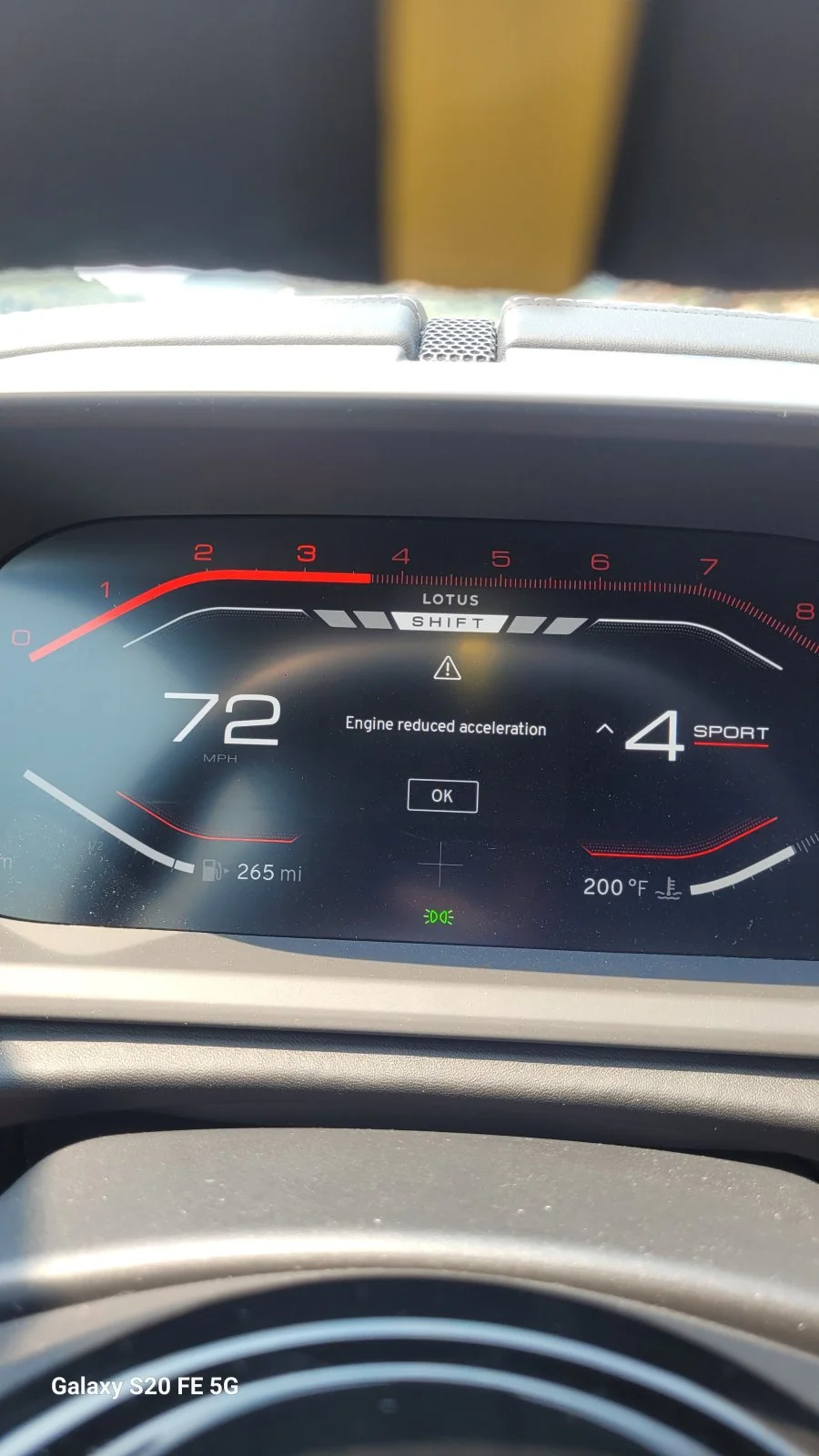

Hi , my car went into the limp mode again today....all 3 similar situation ...
Ambient temp >100F, water temp 200 instead of usual 190.... going up hill hitting redline.... and around 3500 to 4000 ft elevation, the car goes into limp.mode n fuel cuts out at 4k rpm.... my car has 1500 miles n it supposedly has the latest ecu update.... it's there a solution yet ?
Oh n btw, as other 2 times, after I came to the car hour later, it was fine n it didn't happen again as I was driving back DOWN the mountain not hitting nearly close to redline....
