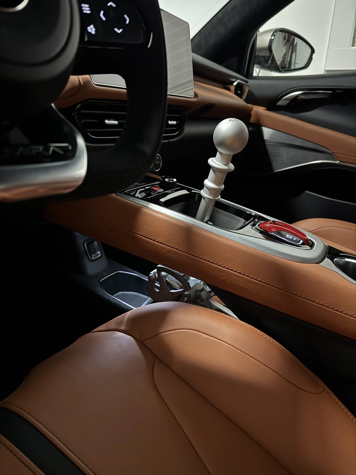

It’s not hard but it’s a pain in the ass. I think more so bc you don’t want to break something and wait months for parts from Lotus. That’s what was going on in my head.
But it is worth it! Parked it’s amazing to admire the pure open experience. Then driving it and looking down just makes it that much more special of a drive. That you @kitkat!
Fyi this is in 1st gear with GRP SS at the max setting.

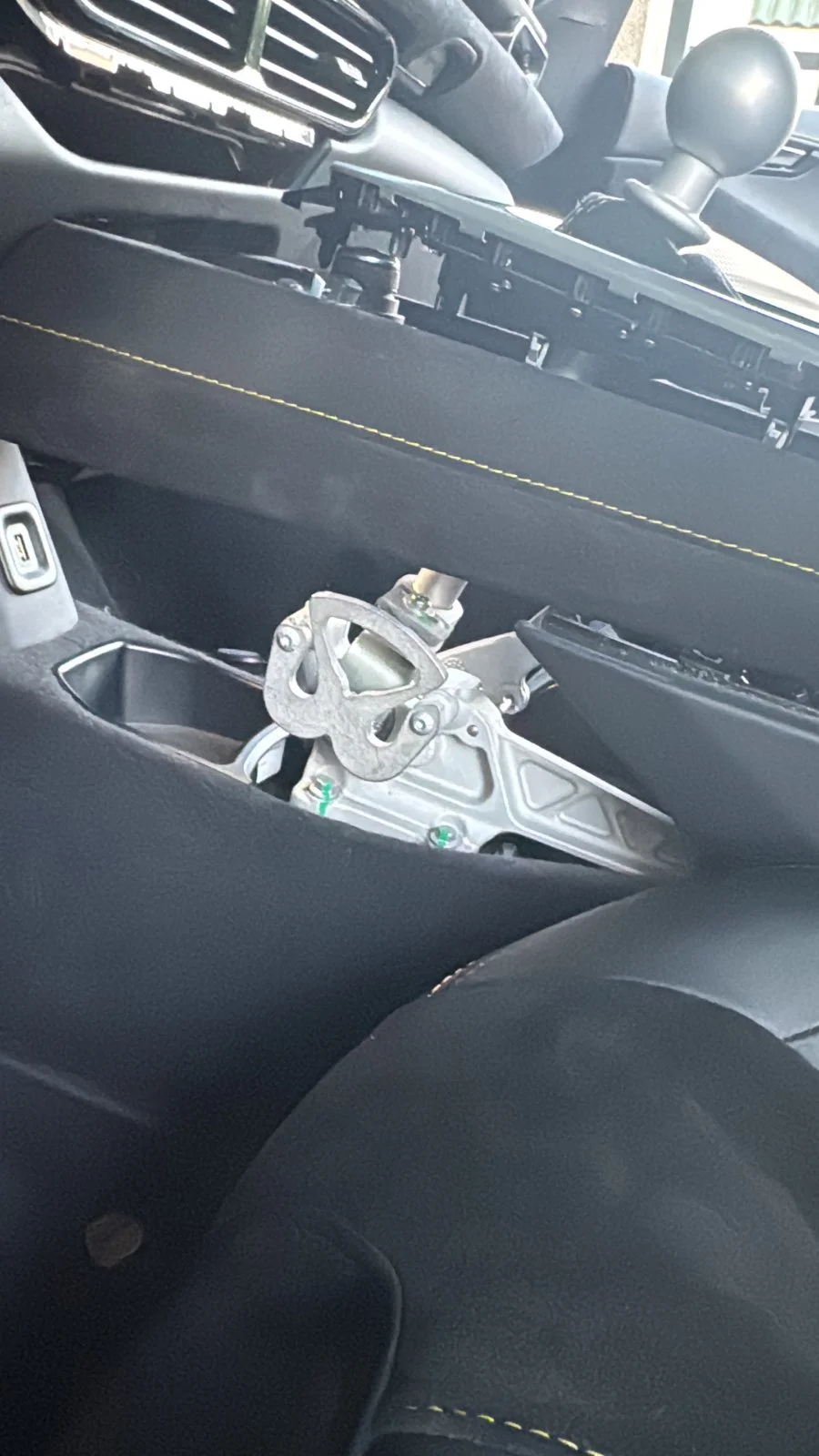

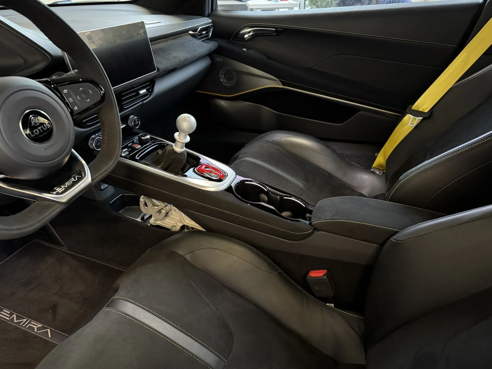

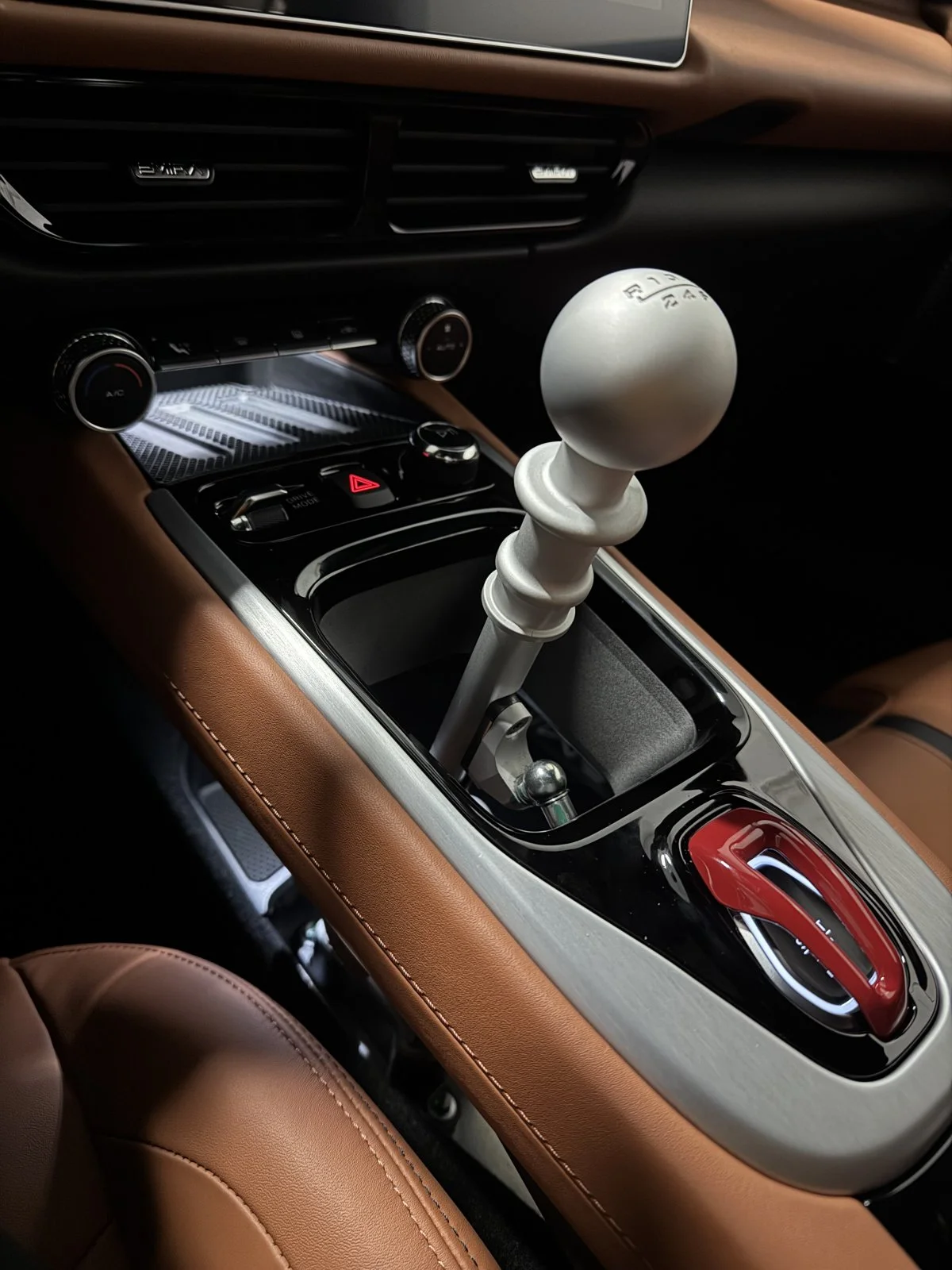

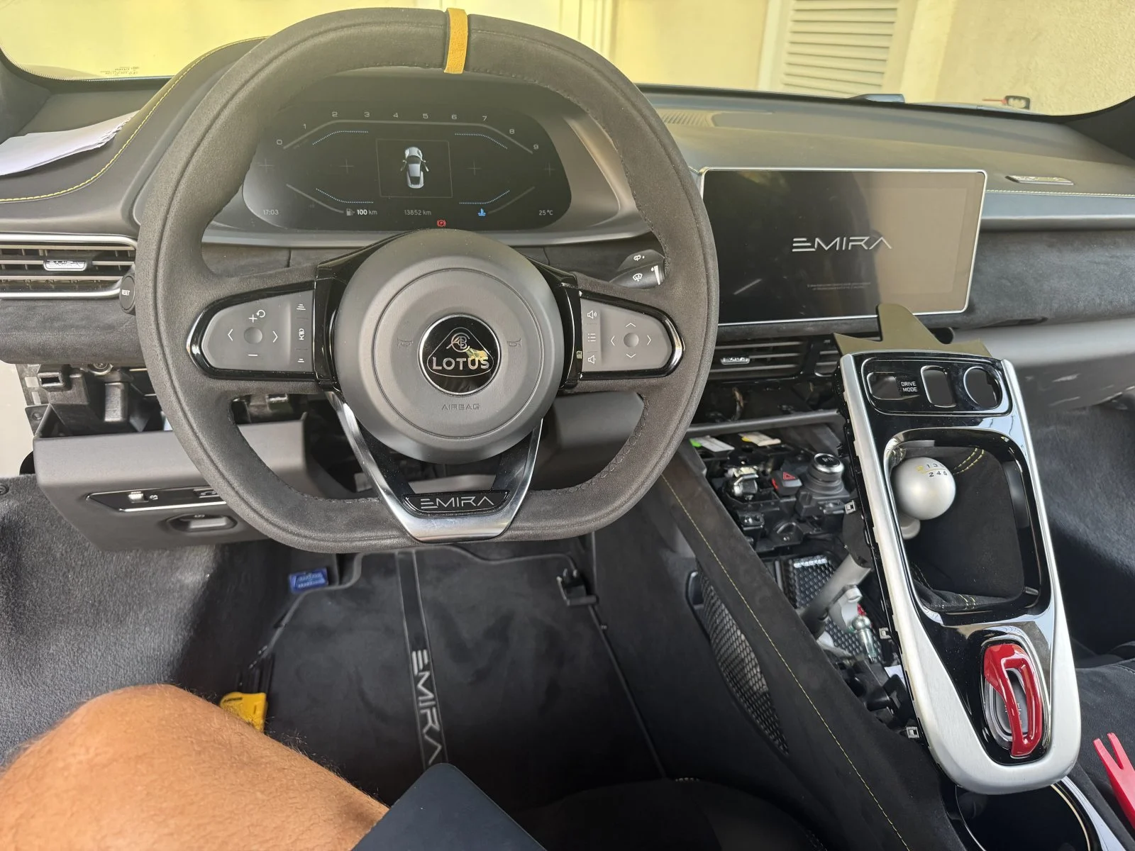

Finally! Did it as well.. the way it is explained here. Thanks @kitkat. It was a pain in the ass and took me longer than expected.. dropped a few clips and had to source them back. The under process shots below. Finished when it was dark so no finished picture yet.
Now I need a 6spd gear plate to cover the top. For the moment I am keeping my alcantara gear gaiter on.. i was more interested in the below exposed gear linkage system.
If anyone has tried the 6spd cover plate let me know dimensions and will do some 3d print models

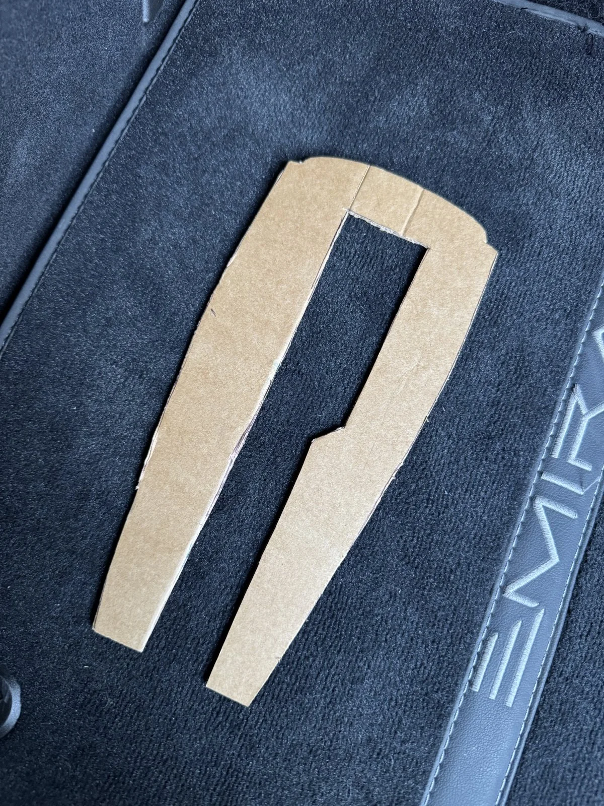

Currently happy with the open gear but the bottom part doesn't look nice plus I have dropped already some stuff in it 😂😎 so have made this design sketch to cover the bottom part, now I need to transfer this into a 3d printed final product.
Any idea or help how I can transfer this cardboard paper design into a 3d printable file?

Could be cut from ABS type plastic sheet that matches plastic in front of it, edges smoothed, then installed?
great idea thanks! Will order it and cut it myself.. i guess thats much easier :)

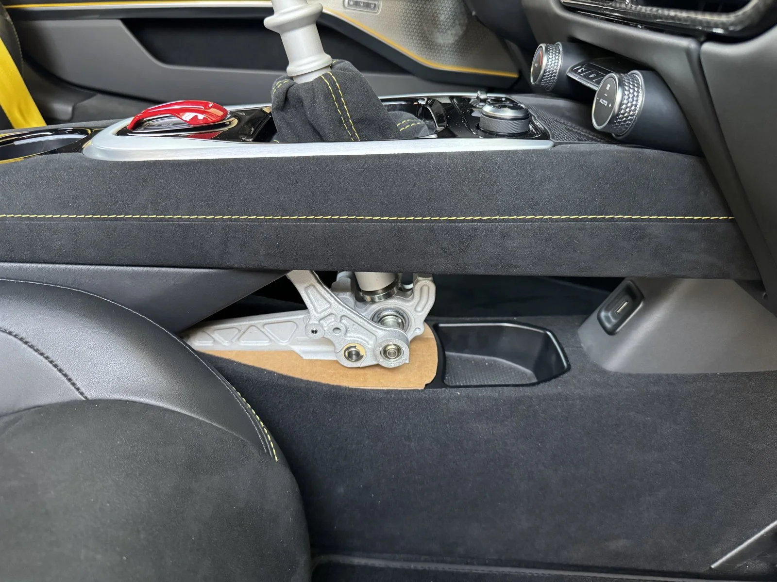

Scroll back to post #73 on the previous page to see my slightly different fix for this.
Thanks.. i have tried to understand there what you did earlier. Now i understand that you have put that plate under which makes sense but how did you get it in there? Disassembled the 4 nuts and slide it under?
Exactly.
Take out the 4 bolts holding the shifter to the tunnel, lift it up and slide the cover under.
