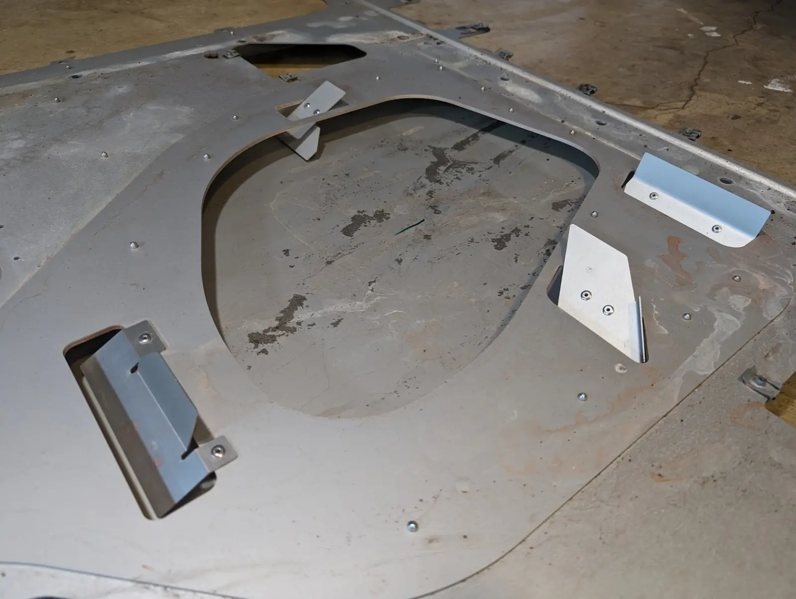

The underbelly pan must've been designed by a high school dropout intern who misspells engineering for their career choice. I considered making a subpanel for oil service in the future or at least drilling a hole so if there are any leaks they would have a more direct path to drip and be seen. You can see the filter housing at least if you peak in through the slotted hole in the panel at the right angle.
TIP: Once you get ALL the fasteners removed (7mm and 10mm only) you push the pan towards the diffuser a bit which releases it from the front brackets. Then the front drops and you slide it towards the front releasing the ears from the back. Reinstall is opposite. :p Havent seen anyone else mention that. Also the pan is sharp on the edges so wear gloves for that part. Dont think they know what deburring is.
The fact Lotus didn't include an oil change / inspection panel baffles me (pun intended). Seems like a no-brainer. But Lotus opted for 39 bolts required to remove under tray instead. Just another opportunity for the aftermarket to step up with a solution I suppose.
"I considered making a subpanel for oil service in the future or at least drilling a hole so if there are any leaks they would have a more direct path to drip and be seen"

Maybe @GRP can come up with an aftermarket under tray with acces panel for oil changes.
The aero panel is quite complex and is probably not the kind of thing that would be cost effective to replace with an aftermarket part. Some kind of modification to make an access hatch would be a better approach, I think, but would need to be done very cleanly and professionally.

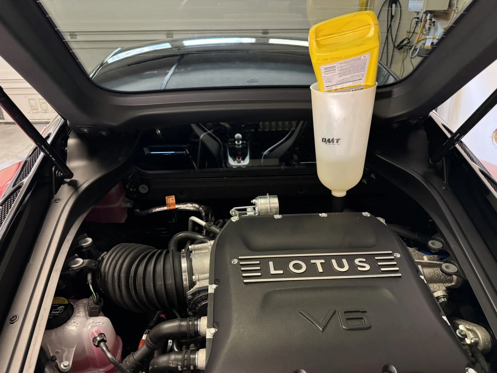

For those looking the oil funnel with case is on sale for $38 today.
Could probably cut that down a bit.
It's got to be better than the zig-zag funnel. That thing is so fiddly to keep still.

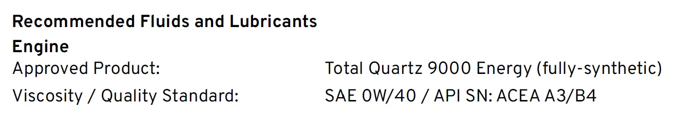

So I've read all this discussion about different oils to use. While i'm sure there are many that will work great, I tend to just use whatever is OEM. What exactly is the OEM oil for this car and where can it be purchase online?

You can’t purchase it in North America, just use any 0w40 SN or higher rated oil.

From page 275 of the Emira Owners Handbook NA:
It looks like it is available in Canada, not sure about the US.

The funnel on this is kind of too tall, it hits the hatch glass, still works but awkward.
I bought something similar from CTA tools. I purchased an offset filler tube (#7472, $22.95) that is made of aluminum and has an adjustment to tilt and lock the funnel. Not sure if it would fit your kit, but hoping it will solve the interference with the glass issue. I'll be doing the 1k oil change this week and will post the results.
