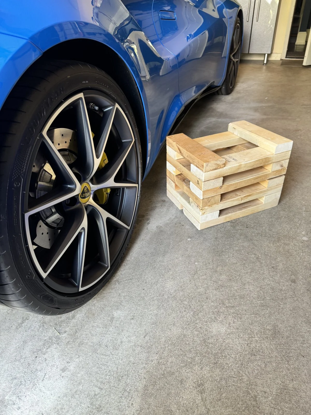

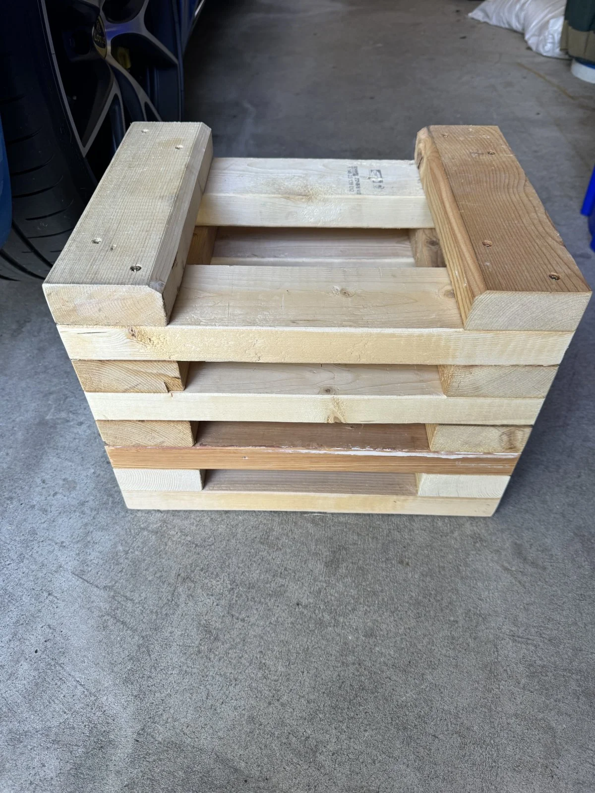

I built a set of race jacks out of 2x4s and was very happy with the clearance for the oil change. I removed the rear diffuser because I was unclear how to separate the two panels (there are 3 bolts hidden under grommets that I should have removed before removing the diffuser). I will not do that next time. The diffuser can stay in place and it should save a bunch of time leaving it in place.

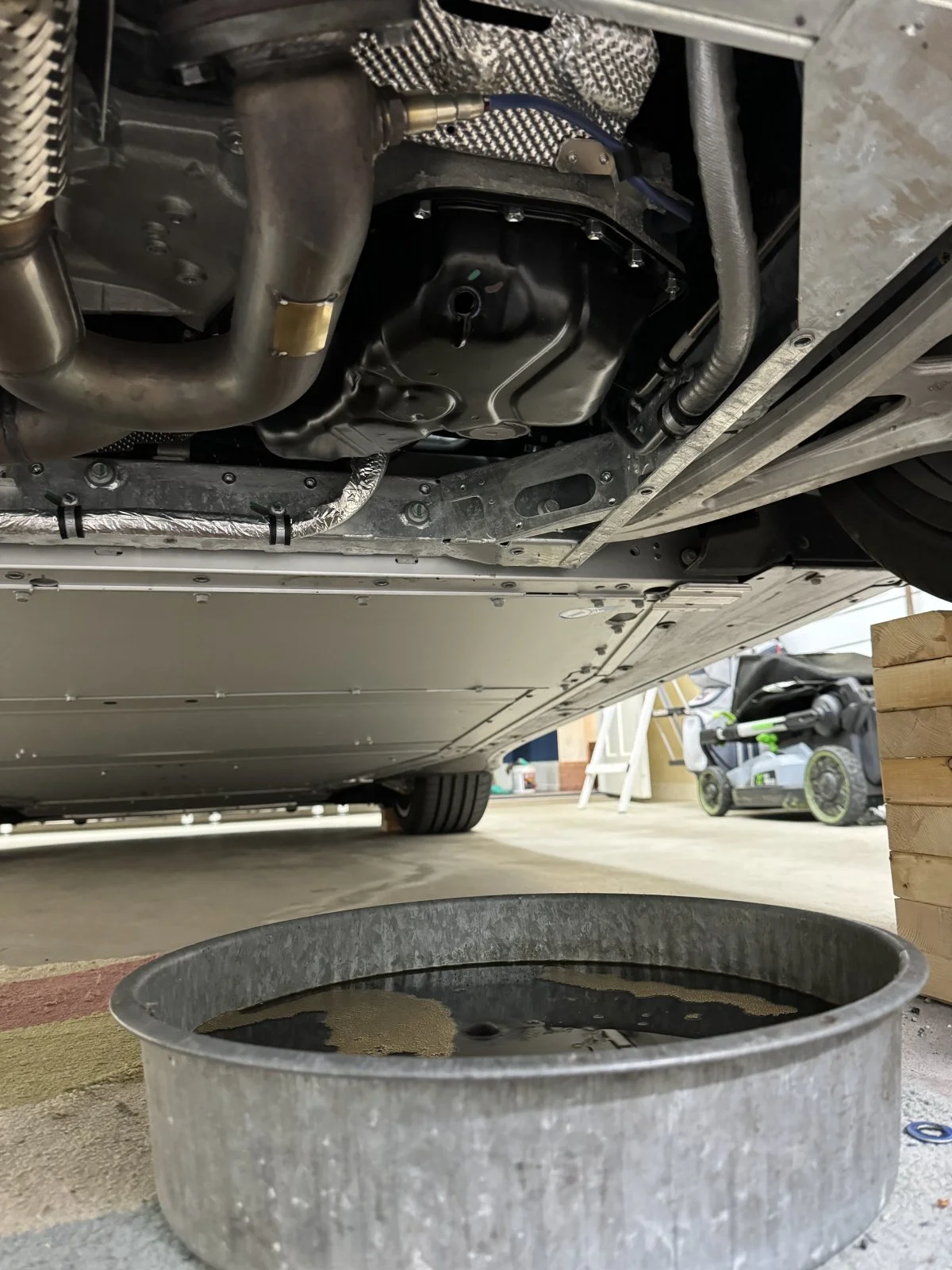

I forgot to share my oil diagnostics with y'all, sorry about that.
Looks like healthy break-in, and I was right to change the oil before 1000mi based on both the metal content and the low viscosity of the oil compared to its 0W40 rating.

I included one photo of the Emira on the jacks… you can barely see it under the wheel. These worked very well and I’d highly recommend making some if you have scrap lumber lying around.
Very cool! So you jack up the car using the rear jack points and then lower the wheels onto these stands?
Yep. For full transparency, I jacked one wheel onto a shorter block first, then the other wheel onto one of these jacks, then went back to the first wheel to replace the shorter block with the second jack. This method felt the easiest and safest. I was concerned that lifting the car fully all at once would be problematic. Worked great and I had a ton of clearance for the oil change.

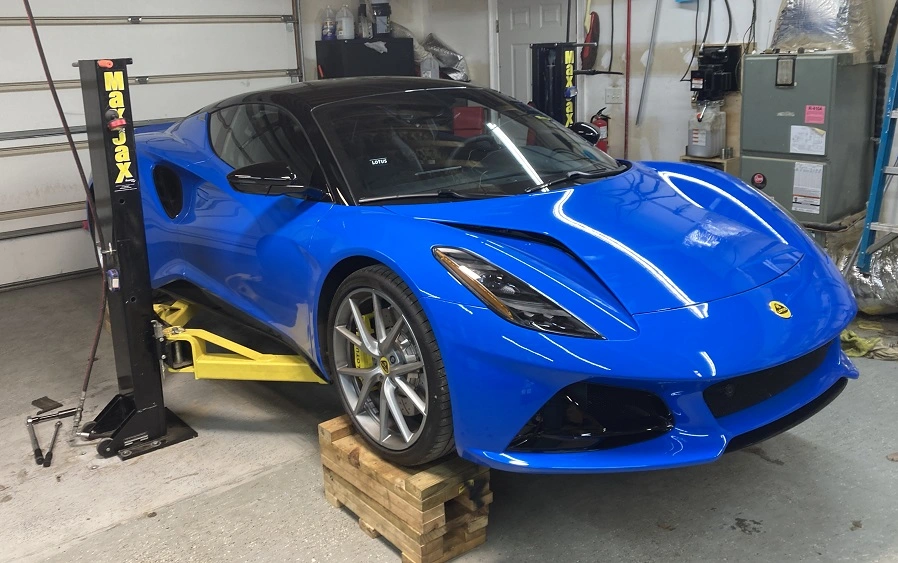

I also built sets of these. I even have a lift but I dont like having cars (if doing a more lengthy job) up on the lift for more than half day so raise it with the lift, then lower onto the stands. Built them before the lift but still use them.

I built basically the same thing, except four, to keep the car level to drain the oil more completely. I had one floor jack and bought another to jack the car up evenly. I started with the rear because the rear jack points are more outboard and easier to get to. Once the cribs were under the rear wheels, I had enough clearance to get to and jack the front with no problem. For me it was an economical and space saving solution for something that I really don't need to do that often.
