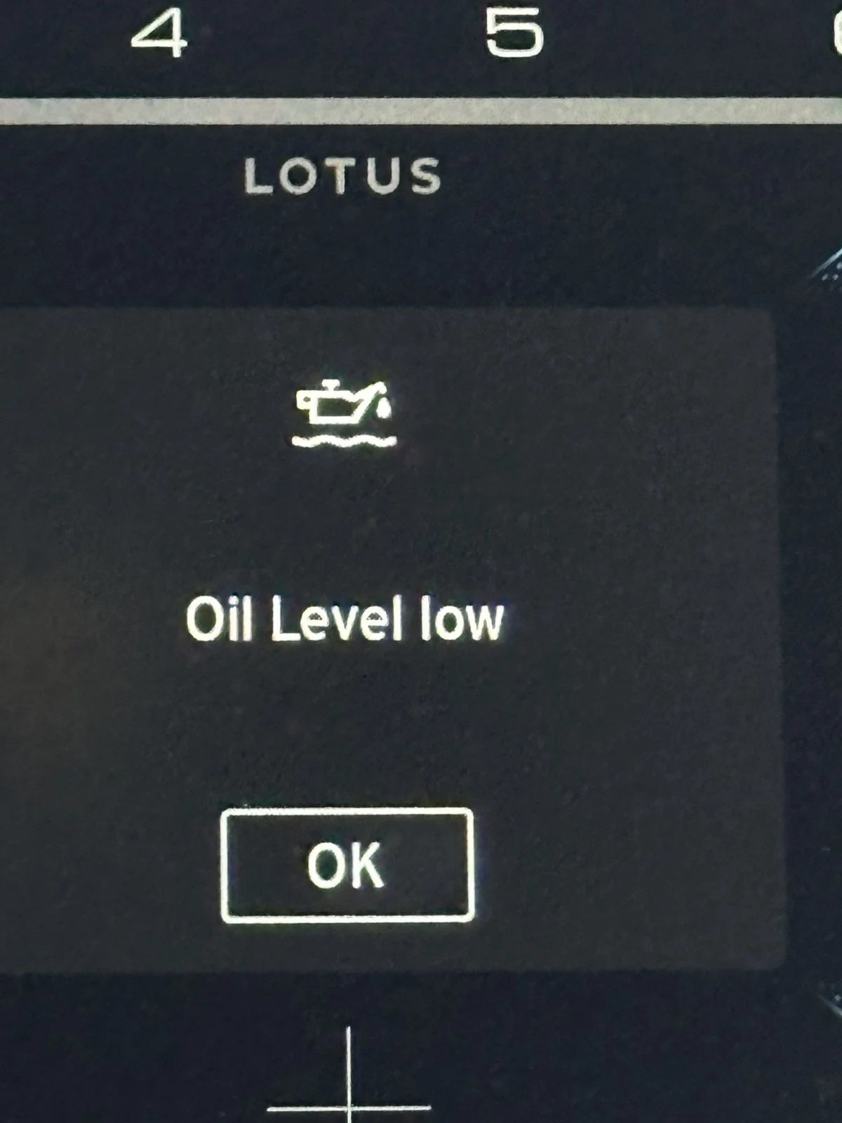

After my first oil change, an Emira owners group I enjoy going touring together with drove to the beautiful Nikko area with beautiful autumn colors. On my way home to Tokyo on the Tohoku Expressway, I received my first OIL LEVEL LOW warning on the dash display.

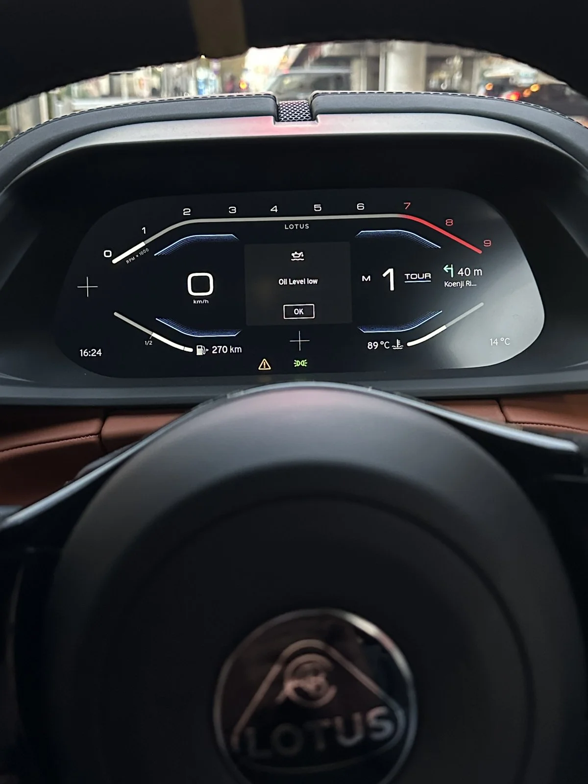

I had another issue to get fixed at Lotus Tokyo service, so I also mentioned about this warning display (that later disappeared). The service staff did not find any stored data on the car about this event, and the car was returned to me without further action. However, on my way home, along circular route #7 (kannana) the OIL LEVEL LOW display returned, and since there was a lot of slow stop-and-go traffic, I managed to snap photos (which I later sent to my service manager) of these messages.

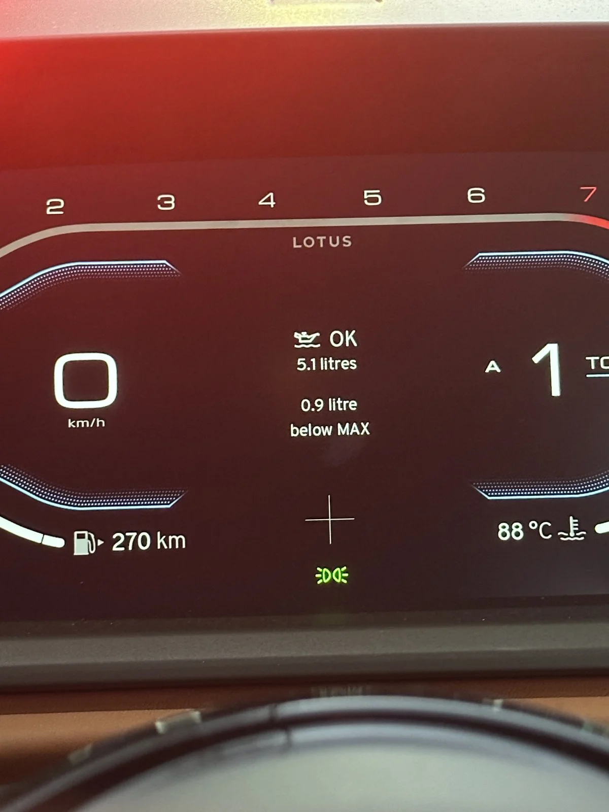

I was eventually asked to return the car to service a few days later. I had also noticed (and photographed) another display you get when operating the right hand side function pad. Here it has an oil symbol and OK, while it also said 5.1 liter and 0.9 liter below MAX.

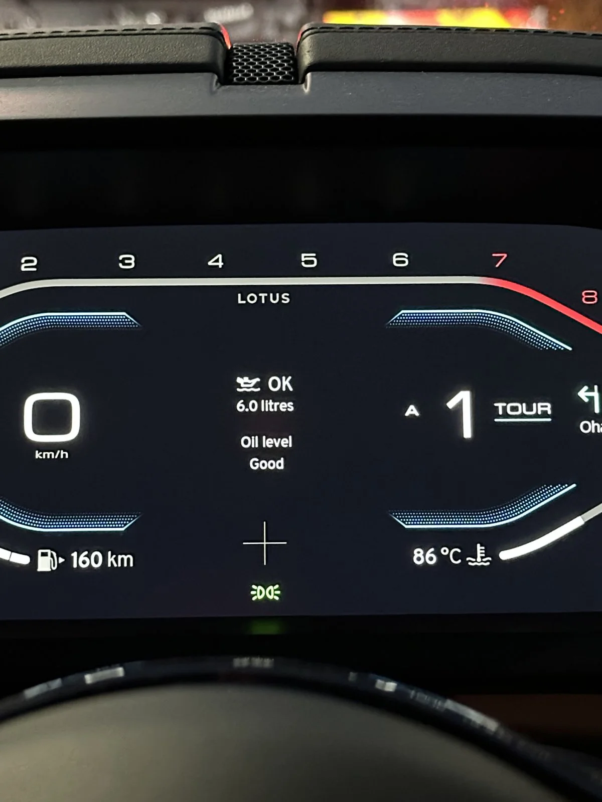

I suggested to service that it might be better if the oil level was topped up to the full 6.0 liter, and they added oil while I was waiting.
After receiving the car back, I checked with the function pad, and now the display said: OIL LEVEL GOOD and 6.0 liter. There has not been any further warning or LOW display after this.
I am not writing this to criticize or to complain. I am simply curious to hear if anyone else have experienced this?
