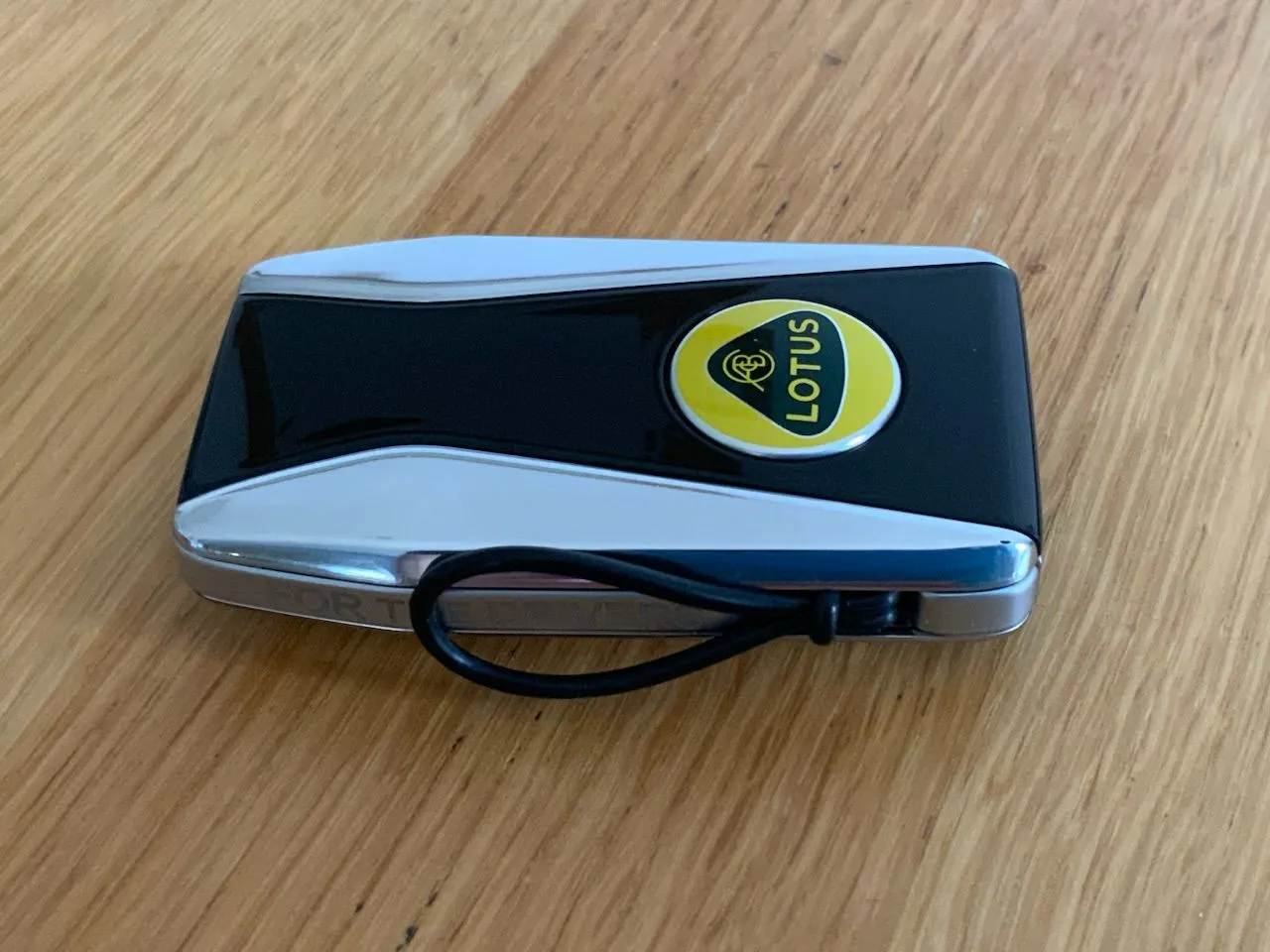

I used the string lanyard to secure the key to the small case I keep it in.
