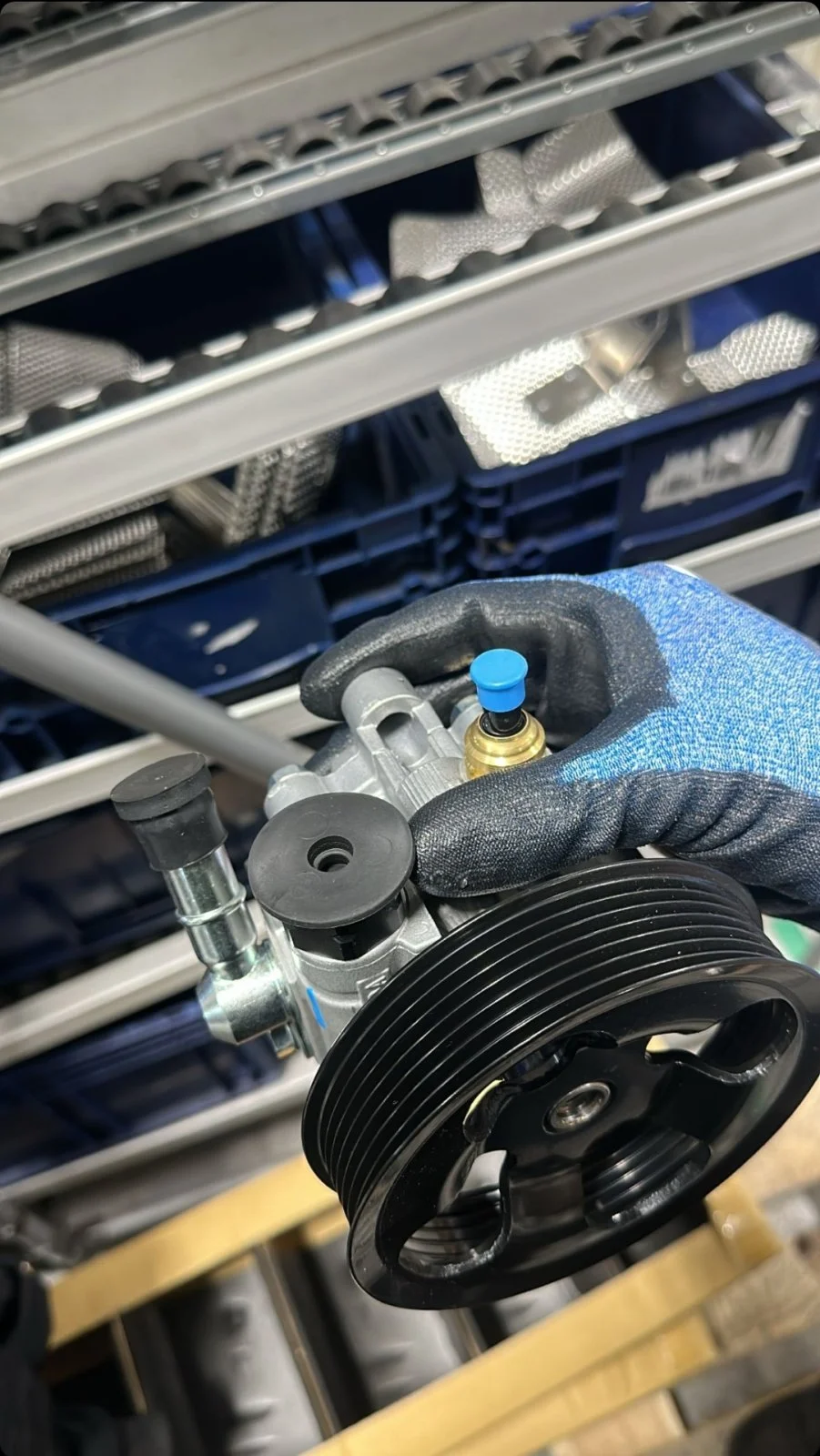

Does anyone know the manufacturer / part number of the Emira steering pumps?
On the Evora it was the Toyota 44310-07040. I would expect the Emira to use the same pump. I could only find the Emira power steering fluid reservoir part number of 44360-33040, which has been replaced with Toyota part number 44360-06030, and 44360-06030 is used on the same Toyota cars as steering pump 44310-07040.

Could your dealer not confirm it is a Toyota OEM part? If it fails on my car I wonder if it would make sense to fit the Toyota unit, (if it is not one already) oppose to the Chinese version that may be coming defected from factory?

Remember, the factory delivery cars were sorted before being delivered. The delivery by UK dealers were likely also fixed prior to delivery. The non-CARB state cars also had ample chance to be fixed before being delivered. The only reason we are finding out about the steering/AC failures *now* is because we are closely tracking the CARB state cars and the dealers are letting us know when they encounter delays due to issues.
It should be a Toyota OEM part. See this thread: https://www.emiraforum.com/threads/lack-of-power-steering-on-day-one.3099/page-5
I was told that this specific part is available in Lotus USA headquarters in Michigan. They will next day freight it to my dealer and get it fixed ASAP. My dealer has seen 3-4/50 cars they have been delivered with the same issue.
I asked about 40-50 emira owners in China, they all suggested it was a common issue from first batch and there was a recall on the steering pump. I also asked if the failure is due to the use of Geely parts. They laughed at me by saying no car in Geely and Lynk & co uses hydraulic steering in their fleet. So I guess mostly likely it is a Toyota part. Something went wrong in the manufacturing process.
From what I've been told by a contact on the assembly line, the problem isn't with the actual pump, but something to do with the lines. Lotus is well aware of the issue and has been for the last year.
I wouldn't make that assumption without verifying. They've changed a number of things on the Emira that were unexpected, and with the PS problems they've had on these cars, the pump might be one of them. I'm not saying it's a non-Toyota pump, I'm just saying it might be a different one than the one used on the Evora.
That sounds probable. A line issue might mean a blockage, which cause a few problems. There may not be fluid to returning to the pump and damage could occur due it spinning without fluid. Also, if the blockage is on the high pressure side, a failure could occur in the pump from too much pressure build up. If it is indeed an OEM Toyota pump, I would say it is highly unlikely that the pumps themselves are failing at such a high rate without some other related problem. It's pretty simple part and they are usually good for 100,000s of miles.
see post #9. Someone disassembled the part and looked at it. It is indeed a Toyota part.
The line could be a problem, or not. It is a myth. I talked to many (40-50) Emira owners who had the steering pump issue, they all have the steering pump replaced once or twice, and the issue were eventually gone. From that perspective, a working steering pump will solve the issue without changing the line.
What I was saying is that it might not be the same exact pump part # that was used on the Evora. Not that it wasn't a Toyota pump.
40-50! I had no idea so many people had this issue.... assuming the actual number is much higher than people you connected with.
