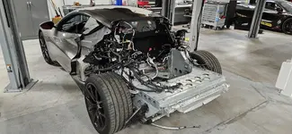

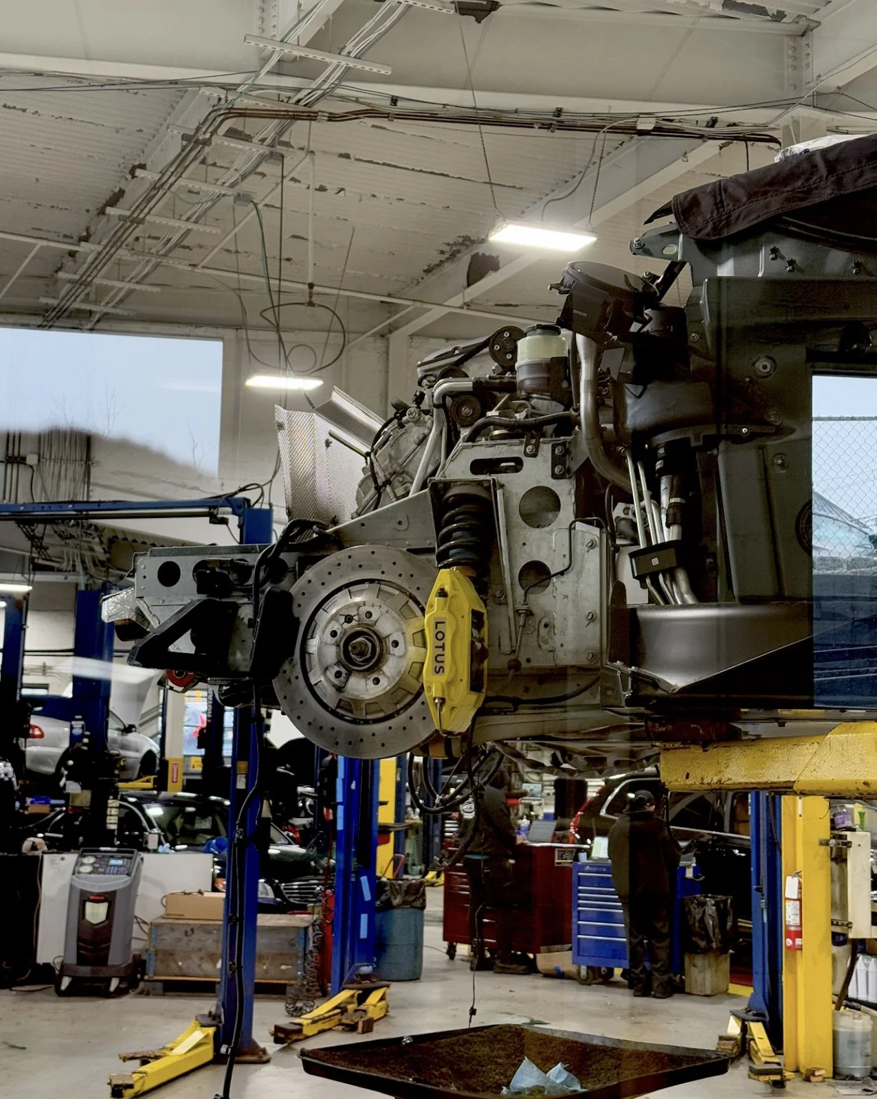

Semi-related, this car at my local dealership needed a new transmission - Entire back taken apart

I had my transmission replaced just last week. It took several weeks to get the transmission delivered, and work took about a week. To the OP's question, the two body panels and bumper comes out.
