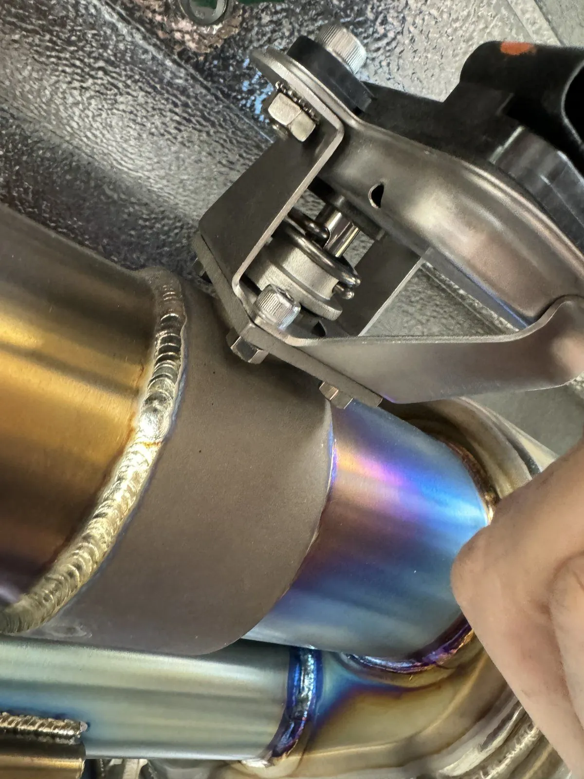

The I4 Ti Exhaust I have, has a different spring arrangement to this. I got a CEL first time I gave it some power/revs. It does seem I’m getting a faint rattle at tickover, noticed on left pipe.

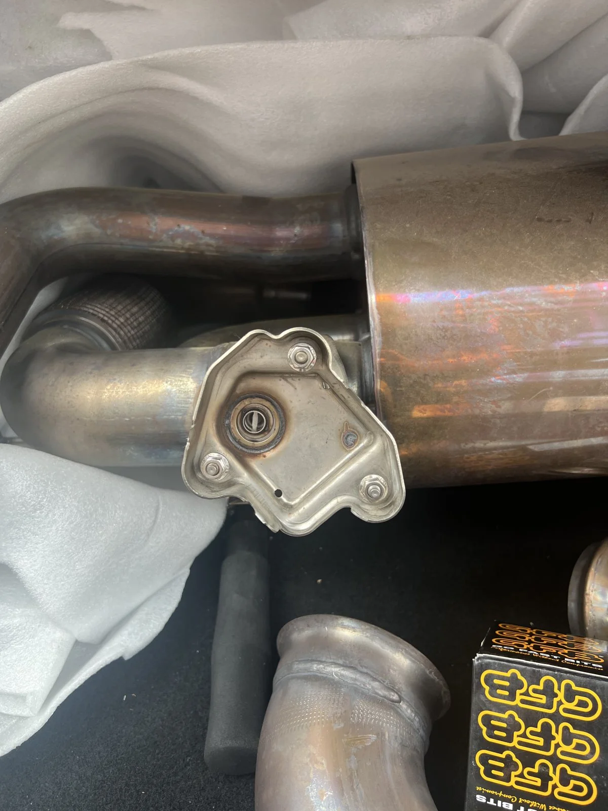

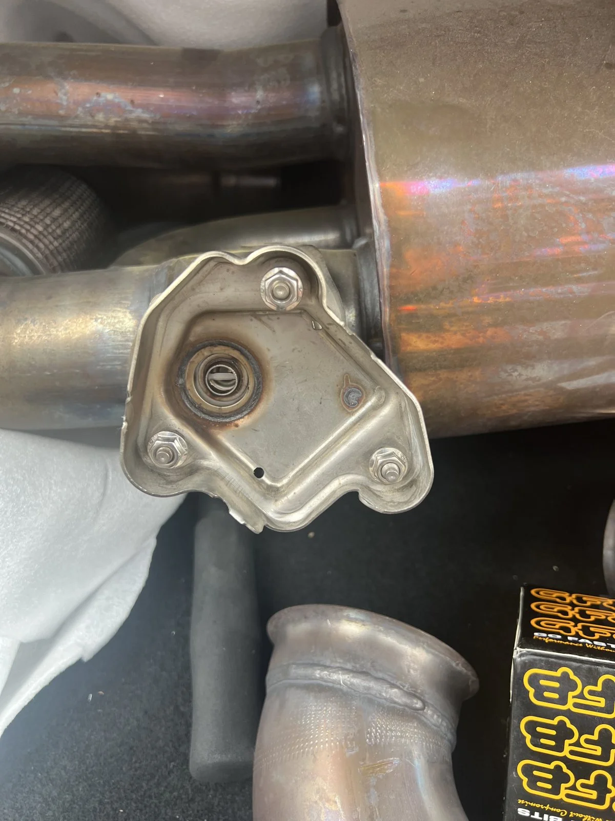

The spring/coupling I have, would cause the valve and motor to be offset 90degs, but this new coupling aligns them. 90degs difference between the couplings is a big difference. New spring, no other change? Seems a bit strange to me.
Had a look at the standard exhaust valve. The valve is offset 45deg, the open and closed position of the valve are shown the images, there is a 90deg range of motion.
The Aerie exhaust doesn’t have this 45deg offset. The couplings are either straight, 0deg or 90deg.
How is the meant to work in the same way, same range of motion exactly? Am I missing something here, or is this just plain wrong?

yeah, but not sure how the new spring fixes it. It might stop the valve rattling when the valve is supposed to be closed, but does it then fully open? The range of motion of the valve is 90 degs and the v2 spring is 90deg rotated, ref the v1 spring. I mean V1 and V2 design has a different valve design, or it’s just a different spring?
Need to get my exhaust off and get a better look at the new exhaust, but it seems to me like an offset of 45 degs is required to match the OEM motor positions for full open and full closed.

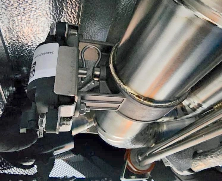

I did, that’s why I’ve got these comments. See these images showing the open/closed positions and see the orientation of the valve motor…. The slot in the shaft on the valve side is aligned with the motor btw, there is no coupling as such on the OEM motor to valve connection.

Ok. It’s a valve that rotates 90degs and a motor (OEM) that attaches to it, to turn it. So what was wrong with the V1 version and what was changed in the V2 to correct it? The only difference i can see is you used a straight through coupling on V2 and a 90deg coupler on the V1. So change the coupling on the V1 to straight through, and so far as the valve/motor is concerned, it’s the same, no?
OEM valve in open/closed position for info.
I managed to drop the undertray and inspect the exhaust valve over the weekend. The valve was actually offset by circa 45deg, relative to the exhaust valve motor (as it should be and my earlier assumption that it wasn’t offset, was wrong). I was getting ECL errors, so I suspect that even though an effort was made by the factory to match the original exhaust valve alignment in the design, but I suspect it might not exactly align and even a very small error can throw a code.
It wasn’t so simple, but I did manage to get my local Lotus dealer to do the exhaust valve alignment/calibration and clear the codes. Super simple job, once you find the correct screen in the diagnostics software.
Now all is working well and no more CEL :cool:
So, to reiterate, I was getting an exhaust valve error (Aerie Ti I4 Exhaust). The exhaust was actually designed with an effort to correctly align the valve, but it still threw an error. A trip to the dealer to get the valve calibrated and all is now well. Sounds pretty descent with the new exhaust and sports cat :cool::cool:

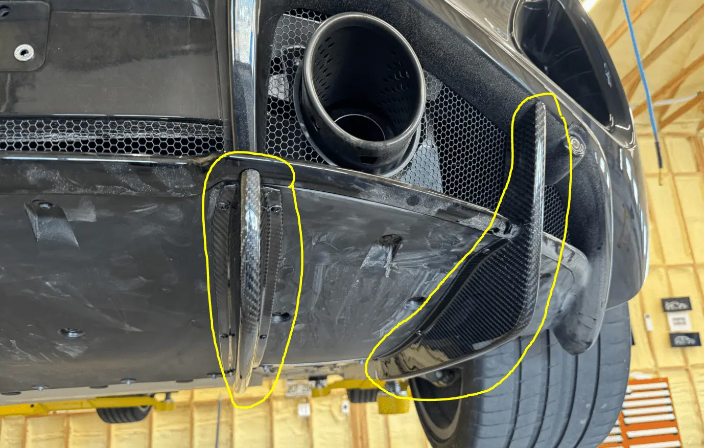

Here is a pic of the Carbon diffusers:
Not really my thing, I thought I was buying a carbon diffuser and not screw on covers.
Not Aeries fault.
