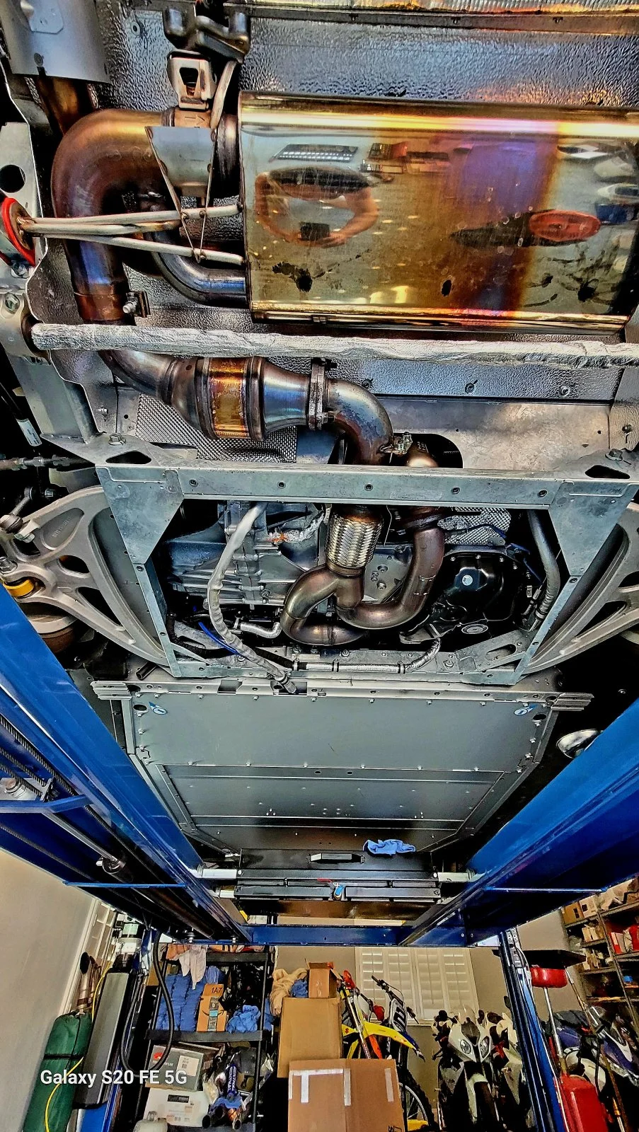

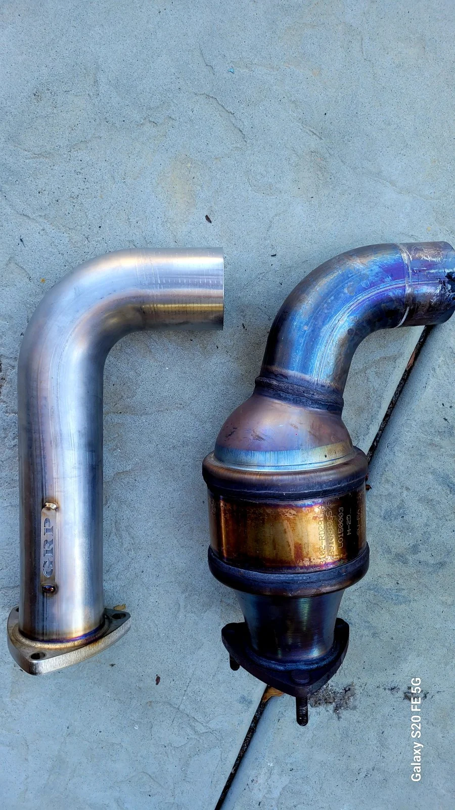

I just installed the 3rd cat delete bypass n miltek valve controller.... was not too difficult.... grp had a good instruction sheet so.....

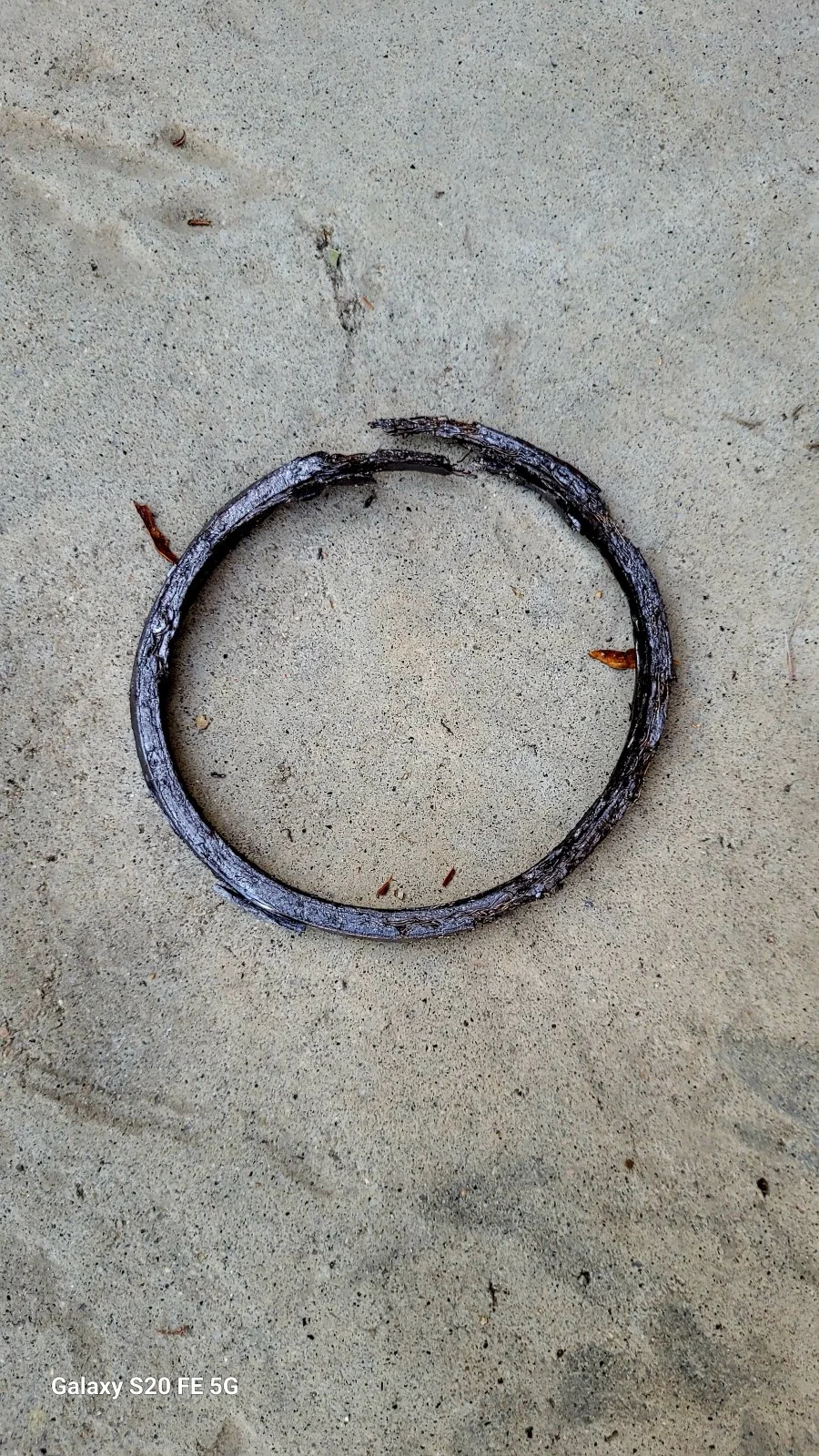

I did my 1st oil change too at 950 miles....oil looked almost new.... any way,definitely get the gasket.... mine was bad on removal of the cat....

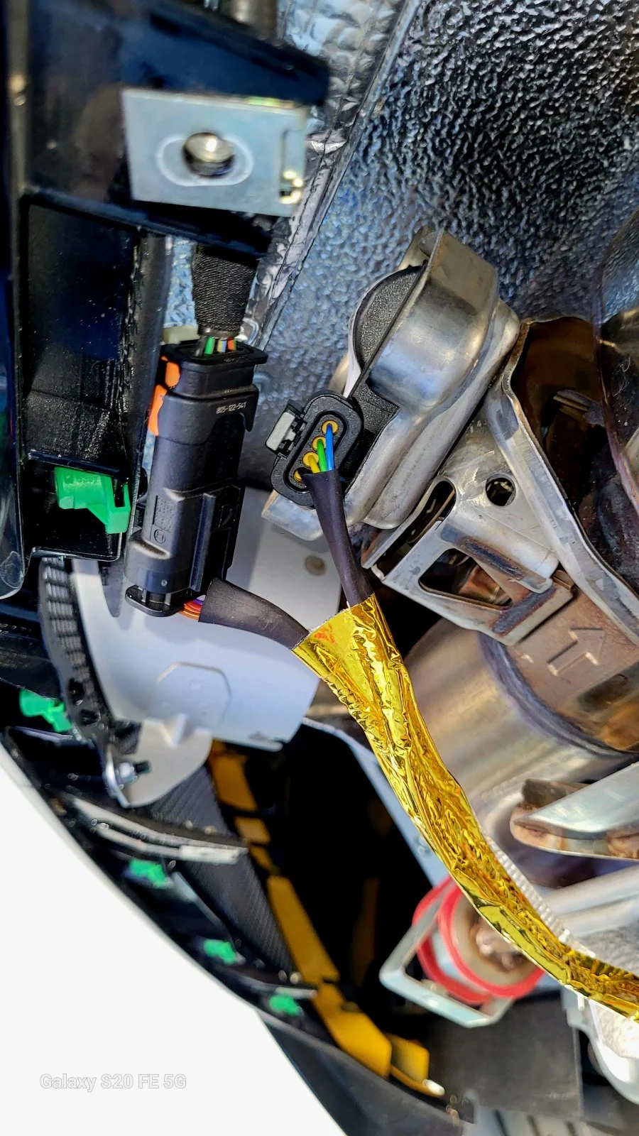

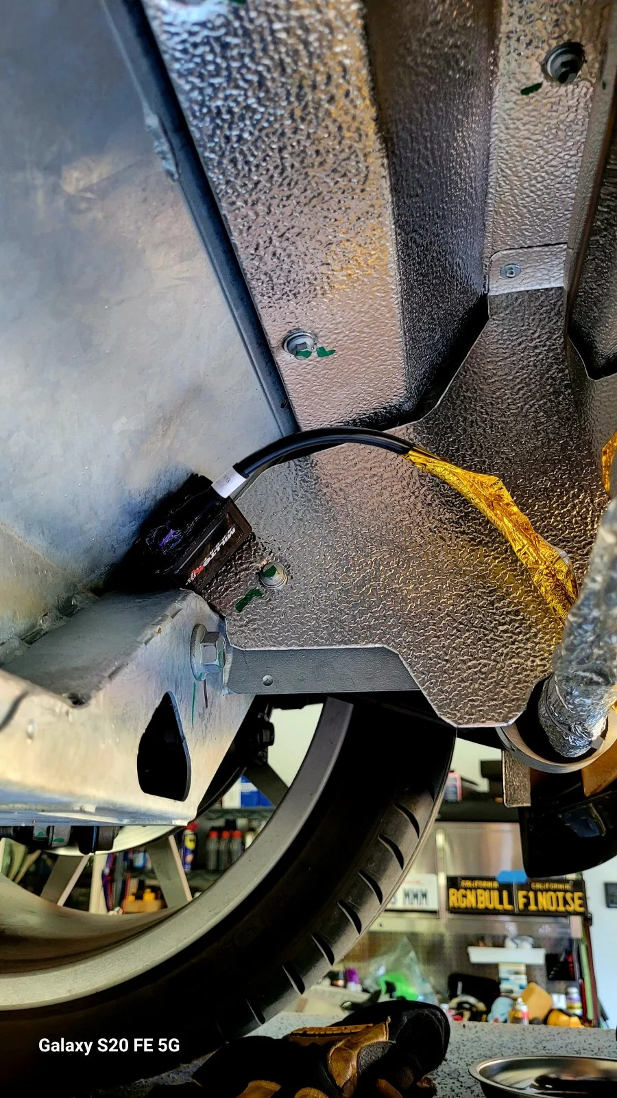

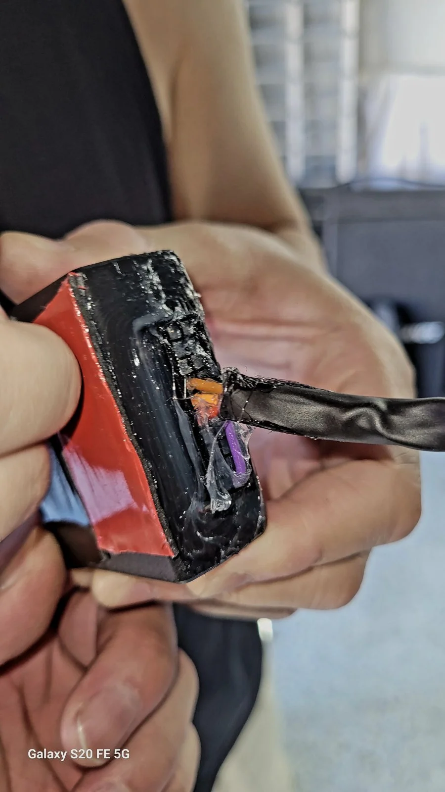

On the miltek valve controller, I put some silicone on the box wiring area so that no moisture can get in there n also wrapped the wires with foil so it doesn't melt with exhaust heat..... I mounted it with dbl sided tape on the rear subframe ... that area will get moisture from driving in rain, etc so, I decided to water proof it.... here's some pics....

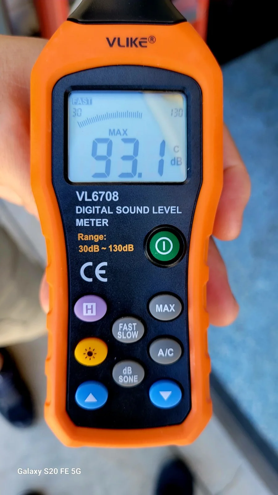

I measured some sound levels....
On stock exh.... using SPL Meter set at dB C to account for low frequency sound, at about 10ft from exh tips....
Oem cold start 86dB C
Sport mode 93 dB C
After 3rd Cat Delete, with exh valves fully open, cold start 91dB
n upto 105 dB at 4k rev blip.
These are just relative figures for reference....
My huracan w fab speed exh hits 115 dB on cold start up. FYI.
There's definitely more decel pop now on fully open.... it is nice having a fully closed option now.... it's quite quiet despite the 3rd cat being gone....
I'd prefer louder if possible.... I may just put an electric Y valve on the 3rd cat delete pipe so that I also have an option for 'straight pipe' level of noise....
