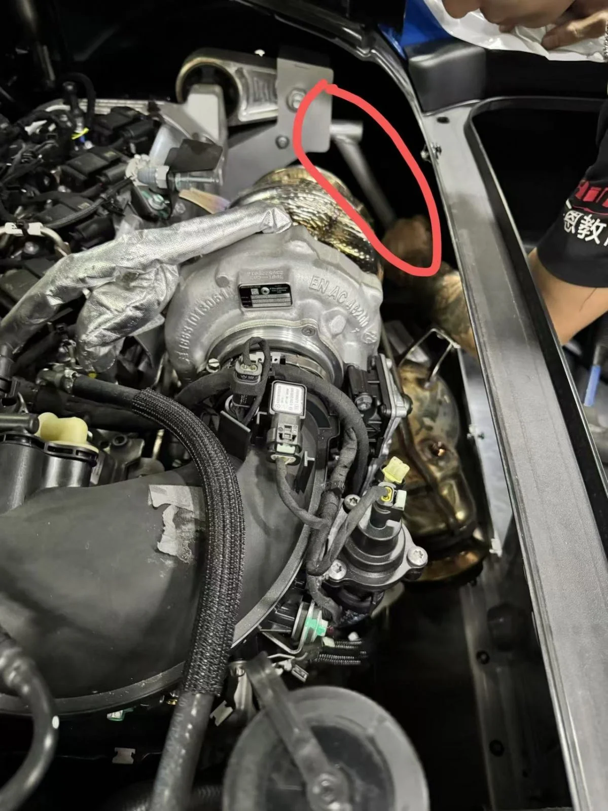

You don’t need to remove the turbo. We removed part of the turbo to get the cat out, but I’m told you can do it without even doing that.
The circled part can be removed, then the cat can be removed through the access panel in the trunk, without removing any of the turbo. This is what I was told, not what we did when fitting my cat.
I also only un clamped the hot side of the turbo, it made removal easy.
That’s what I meant say :) I didn’t do the job myself, was just keeping an eye whilst others did the job.
Apparently it is easy if you remove that part I circled above. Only got this info after it was all done, so not too sure about the details.
