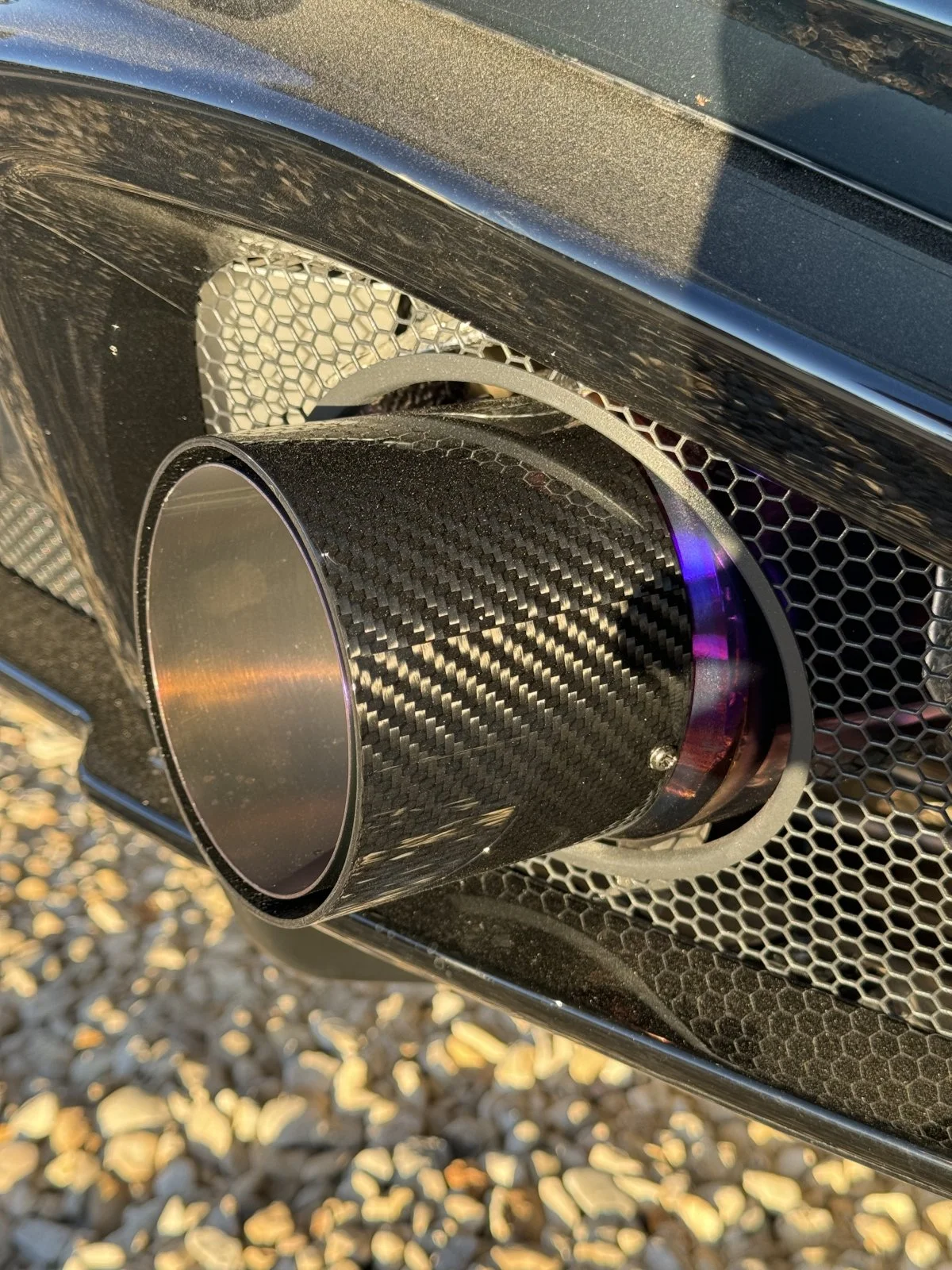

It is louder and better sounding over the stock muffler. It projects rearward more than forward towards the cab, as the stock exhaust does. Several times, with the valve 100% open, I had to roll my window down to check the sound because I thought I had the valve closed. Once I rolled the window down, I could hear how loud it was outside, but not in the cabin. I think some of this rearward sound projection could be from the solid titanium exhaust tips. The stock exhaust tips have a lot of perforations in them, and I would be interested to see if someone just swapped the exhaust tips to a solid pipe that comes with the titanium exhaust to see how much that alone reduces the exhaust sound in the cabin.

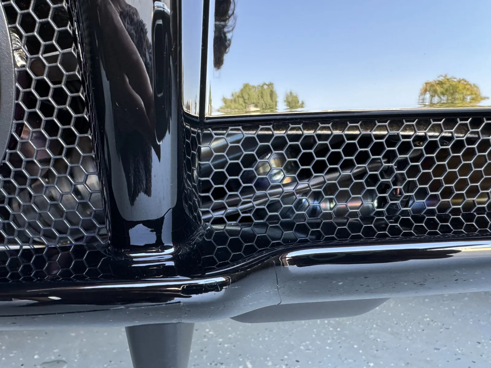

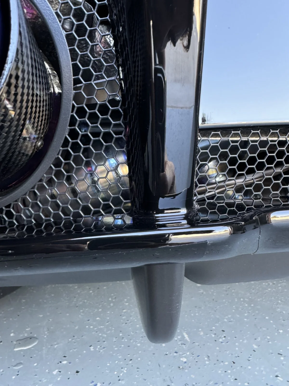

If you want a more tuned-sounding exhaust note, less exhaust resonance in the cabin, 20 lbs of weight savings, and awesome-looking exhaust tips, then the Titanium exhaust is the way to go. I'm enjoying having a quieter cabin. The stock exhaust was boomy and resonated more than the Ti exhaust in the cabin. The Ti exhaust sound is crispier and projects rearward more than the stock exhaust. I also really enjoy seeing the blued Ti exhaust when I peek through the mesh in the rear bumper (the camera doesn't capture the true colors).
