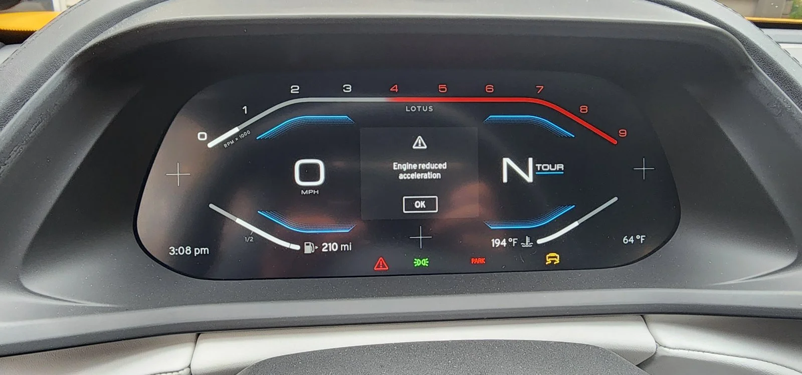

Any other additional information on this issue? I have about 650 miles and have experienced this warning three times to date. Always clears after a restart. Finally got a code reader on the car before restarting and have a pending P0111 code. Had been driving on the highway at high speeds but not high RPM since I am still breaking in.

I still get the P0111 code occasionally. I can almost trigger it on command with a sequence of drive mode changes which is interesting.

I suggest bringing the car in for service. Not worth f-ing around.
