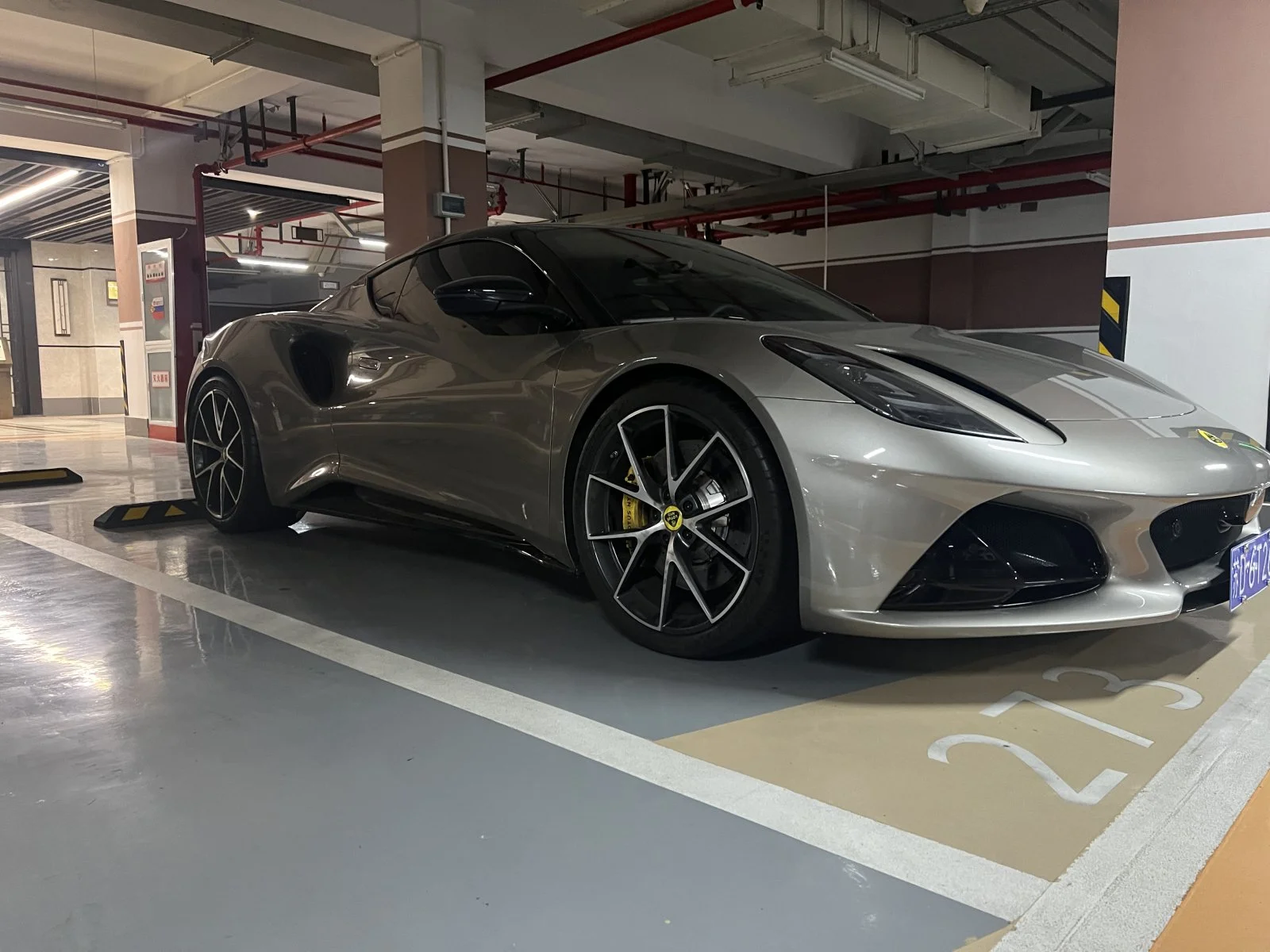

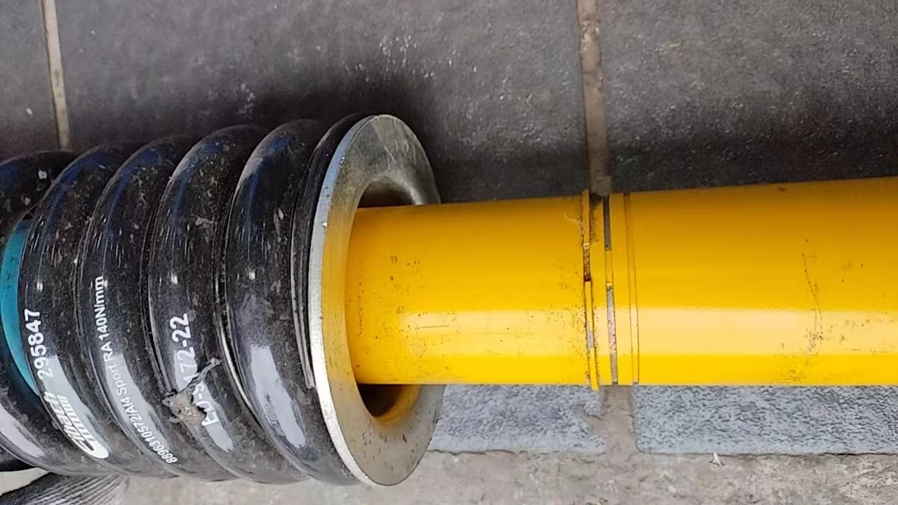

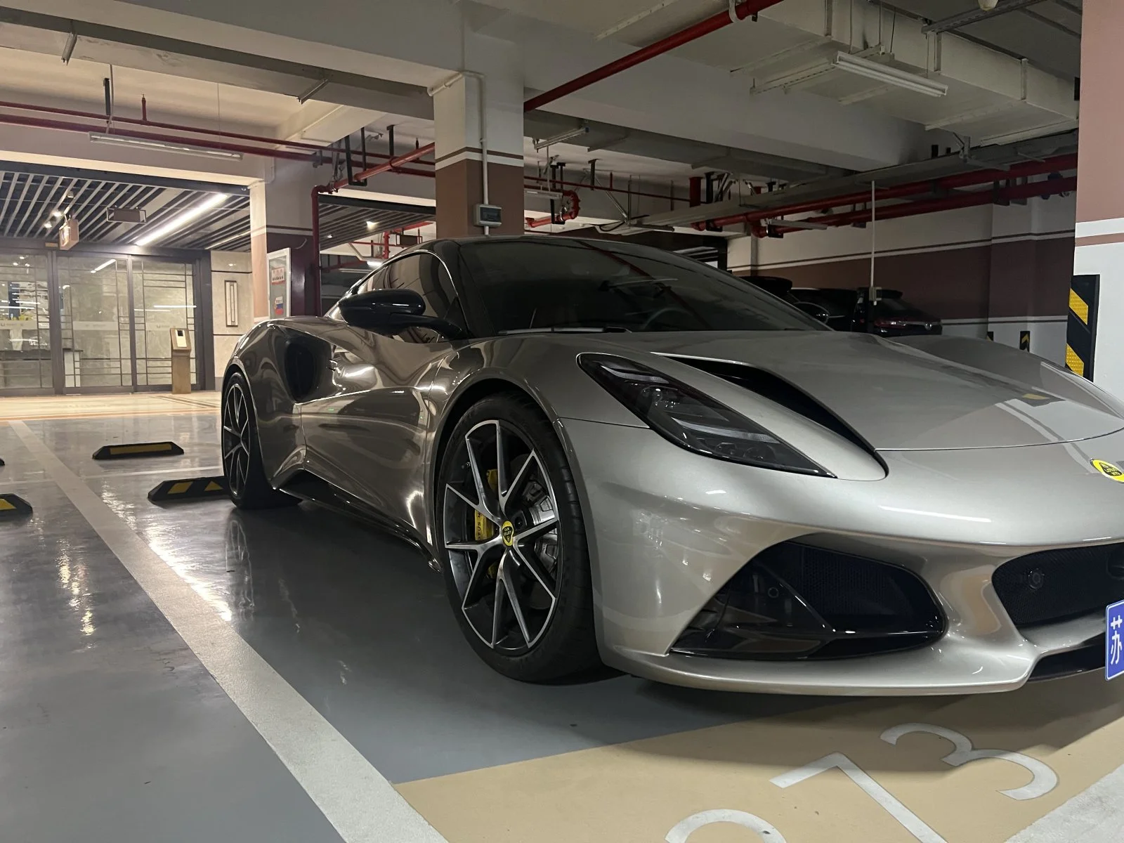

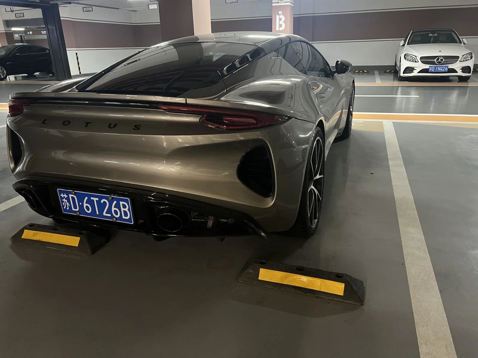

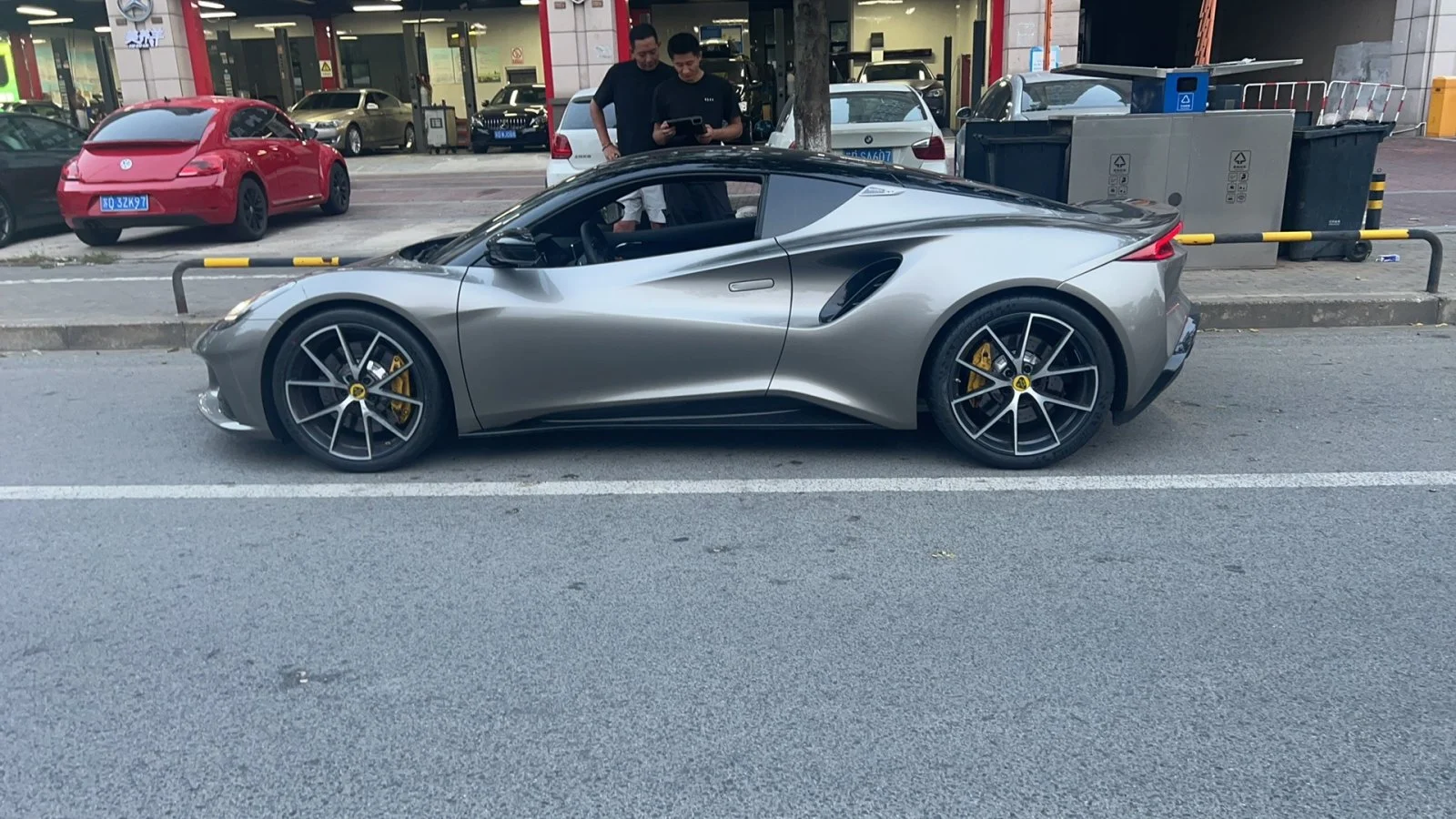

Swapped my F1 tyres to Cup 2. Also lowered my I4 Emira (without buying anything).
The I4 Emira is setup with the circlip on the shock absorber in the highest position, so you move it to the lowest (10mm difference on the shock body) and you have a small (but noticeable) drop. Didn’t do a before measurement, but it’s noticeable.
My car is a China I4 Emira, other markets may, or may not be setup like this. Together with the 12mm spacers and the small drop, the car definitely sits nicer than it did.
Interesting... makes me wonder if all the early hoo-haa and confusion around stock ride heights was partly caused by variations in the installation of that circlip.
Regardless, lookin' good 😎
So far as I understand the sport I4 can do this trick on the suspension, but the Sport V6 isn’t setup in the highest position on both shocks. I’d guess each model has its particular shock setting, but who knows….
After a recent track day, I came to realise what a great setup the existing suspension is. I’m happy to keep that, get it a little lower (on the cheap) and not compromise anything really. Was just about to get the GRP kit, but I think I may stick with this, at least for now.

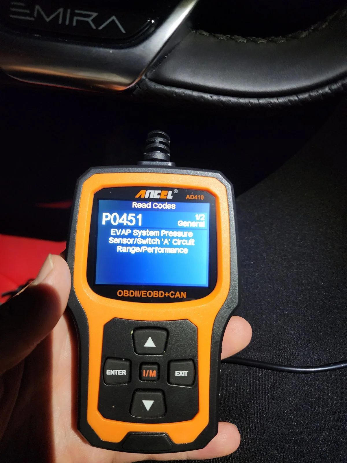

@Time2Fly i just got obdii scanner from Amazon and scanned for code. It's evap pressure sensor ? Code which I don't know what this is but would eventuri Intake might have caused it? I accidently delete the CEL but would this something that I have to take it to the dealer and repair? Please 🙏 tell me if anyone know what this is ..
